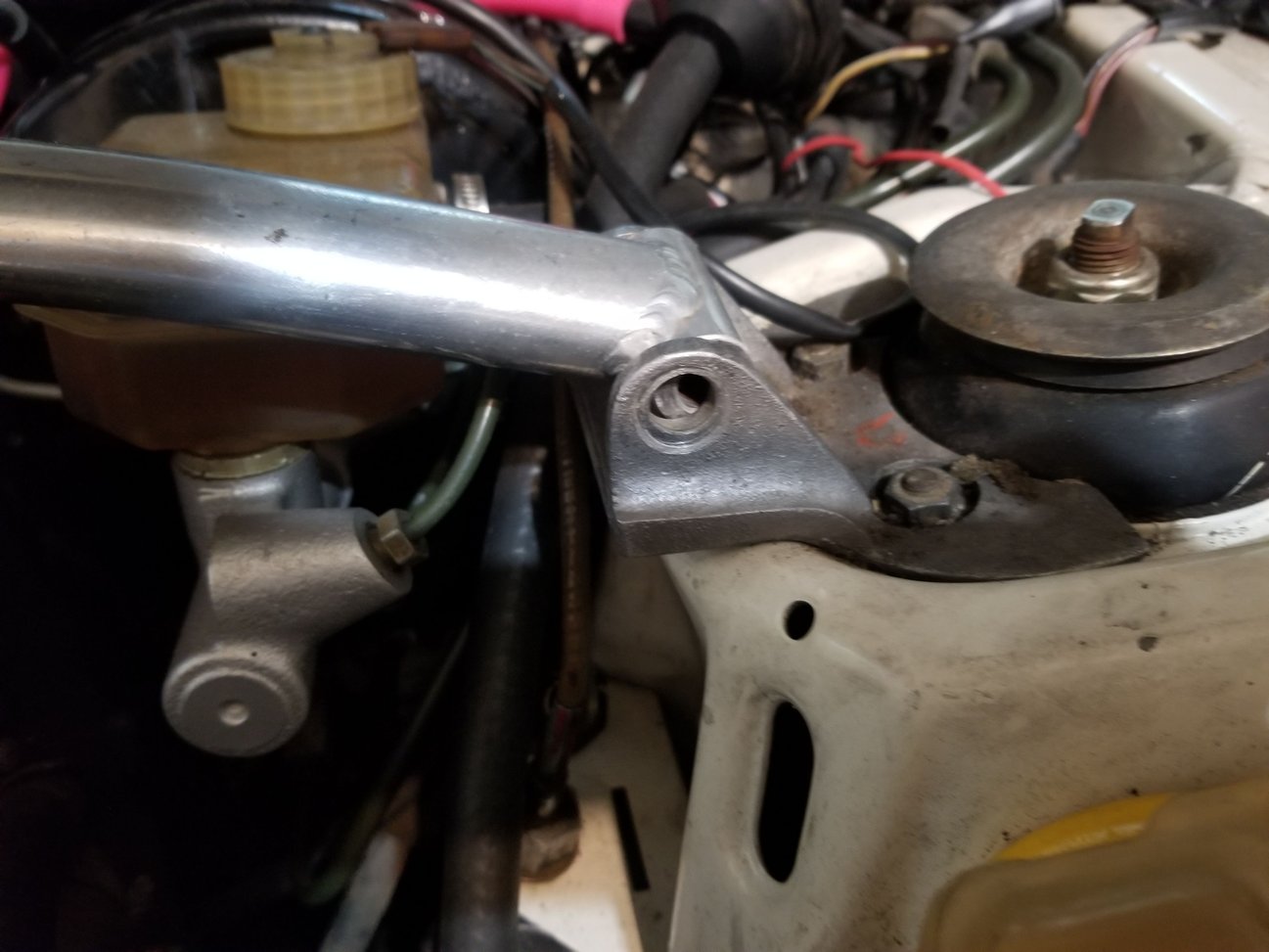

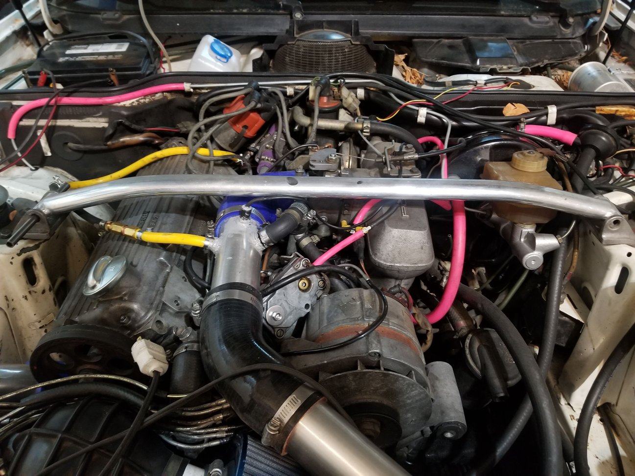

has anyone else had this issue? I got a strut brace that came off a 944, but when put on the 924, it doesnt line up, its about 6mm narrower. Debating on how to make it fit. I feel like I have to cut one side of the bar off and reweld the end piece on

My bar is very similar, Ive seen it mounted on a 931. I saw it in a "for sale" for a car, and asked if I could buy the bar separately. But obviously my engine sits higher than his, since my boost pipe hits the bar.
In this pic you can see the difference between jackstand (sat there for a year) and dropped down on the wheels.
The bar looks like this, similar to yours.

Interesting: So apparently, I did have the car jacked up slightly, just a couple inches, but the wheels were still touching the ground, SO I decided to jack it up so the front wheels were fully off the ground. and monitor the Mounting hole Pictured, Noticed no change.
THEN, I fully lower the car and noticed I the hole offest got even bigger, now its about 8mm off.
