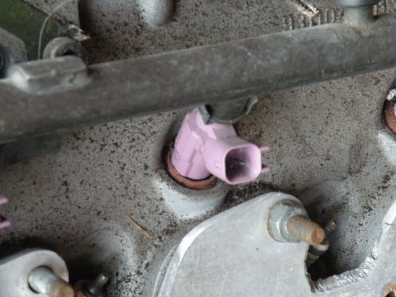

The engine has pink/purplish injectors, and a fuel rail. I have a spare fuel rail like this if anyone is interested. Here's stuff that came with the car that I have questions.
1. Anyway, can anyone identify the injectors and if they are appropriate for an EFI application. Or, what specs they might have. Or, where I might find this information.

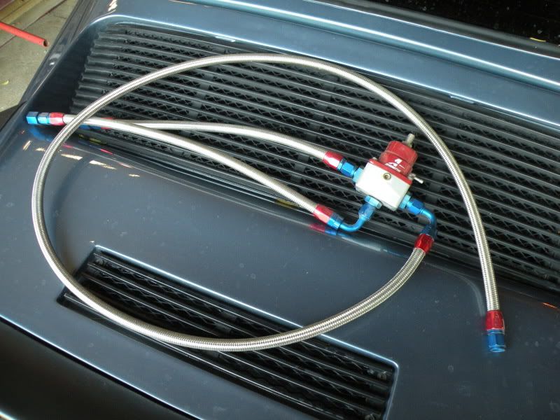

2. I have the fuel lines and fuel pressure regulator with vacuum port for boost, and a port for a fuel pressure gauge. Ok on that?

These look like your injectors you have there:
http://cgi.ebay.com/ebaymotors/SMP-STANDARD-FJ729-Fuel-Injector-_W0QQcmdZViewItemQQfitsZSubmodelQ3aSRTQ2d4QQhashZitem3a64f396afQQitemZ250801788591QQptZMotorsQ5fCarQ5fTruckQ5fPartsQ5fAccessories
From a Neon SRT4 (2003 only). They should support 225 whp.

The FPR and fuel lines look good.
