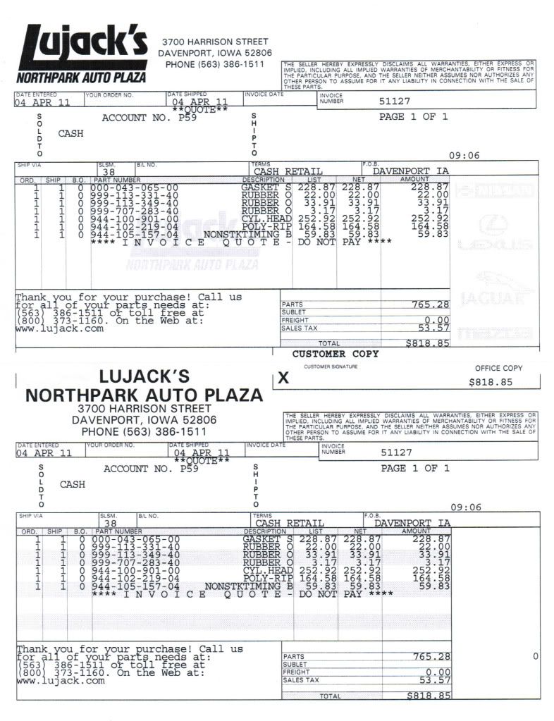

PostPosted: Tue Apr 05, 2011 6:39 pm    Post subject: Dealership Strikes Again Reply with quote
So I contacted my local Stealership and got a price quote on the parts i would need to do the timing belts and what not as well as front seals for my 924S.
This is the invoice they sent me:
http://i1000.photobucket.com/albums/af125/headstrong2740/porsche/porsche_parts.jpg
The problem here is they did not include the Pulleys or tensioner at all. and in top of it.. i can get most of these parts from Pelican for about $174.25 total.
I still need the seal kit for FOES which i found at this place:
http://www.pap-parts.com/prodinfo.asp?number=000+043+065+00
Any thoughts on this company or anybody use them in past?
I still have to round up the tensioner parts as well as the other pulleys. Just need to figure out the part numbers so i can just add them to my project list on Pelican.
Let me know if you guys know of a timing kit that would save me money overall and time. From the looks of the stuff im getting from the delaership parts ...i have the older engine (86 year)
Its also the Automatic Motor on my end (wish it was a manual)
Anything else you guys see that I am missing let me know.. i will be ordering everything and the tools i need here in a few weeks... this way its all sitting there for me when i get home.

PostPosted: Tue Apr 05, 2011 9:55 pm    Post subject: Reply with quote
Your MOS (military occupation specialty) must be in the supply department. Only the government would pay these prices, not an owner of a 924S.
Ask them how much the labor will cost.

PostPosted: Wed Apr 06, 2011 3:36 am    Post subject: Reply with quote
http://www.lujack.com/index.htm
John
Well for starters im not paying them anything because i dont want to over pay for my parts.
The labor i will do on my own since it will give me somthing to do when i get home to relax. I have a strong Mech. Background and will have the tools ordered as well so i should be fine. This will be my first porsche engine work though so i will be learning alot im sure.
Ill probably be asking lots of questions once the process begins. But the nice thing is this will allow me to check alot of things and rebuild the vac. lines as well as clean alot of grounds as i get to them.
The other issue i hope to fix in this process to.. with some other parts.. is the bad idle... it will sometimes idle just fine, but then randomly die and not fire up for a few minutes... so im not sure what the deal is there but could just b a vac issue... but i dont think im that lucky
