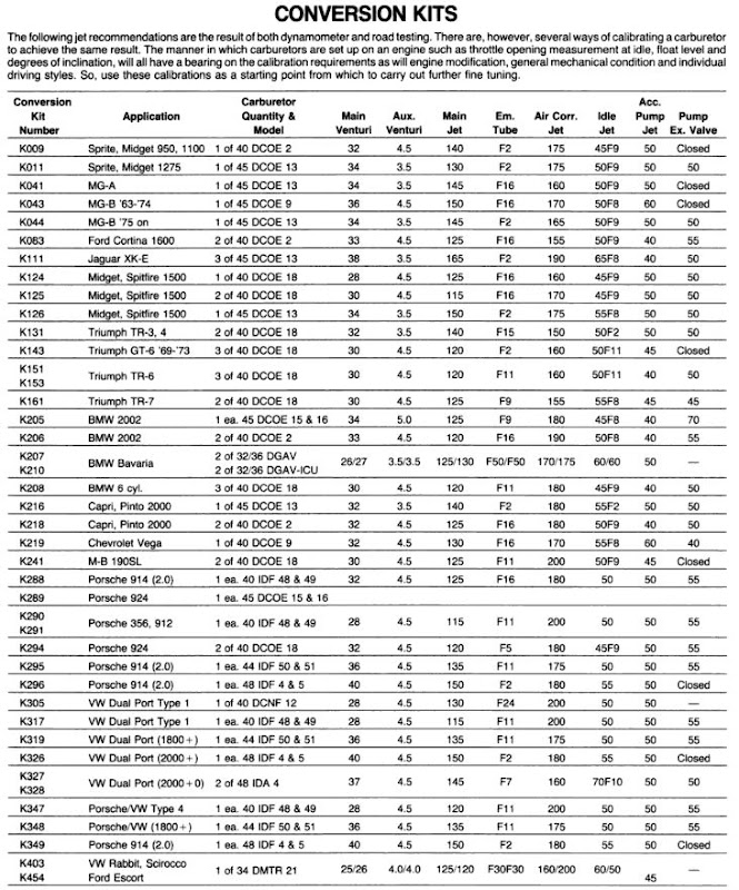

Hi to the members of the board. Can anyone help me with info regarding the jetting, choke tubes etc, as I somehow misplaced my info.
Many thanks.

PostPosted: Thu Jul 02, 2009 5:07 am    Post subject: Reply with quote
This might help:

PostPosted: Fri Jul 03, 2009 5:25 am    Post subject: Reply with quote
Thanks a million Ideola.
