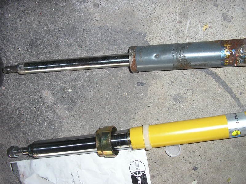

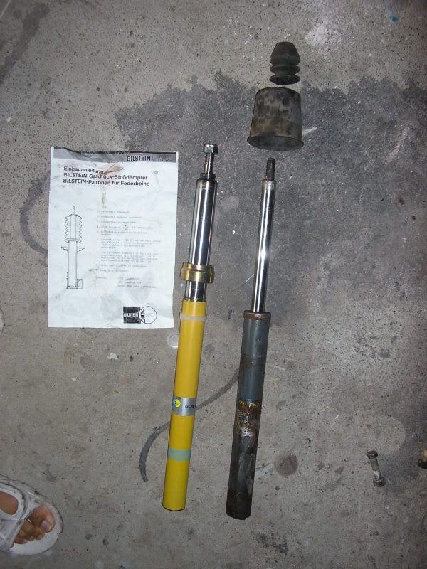

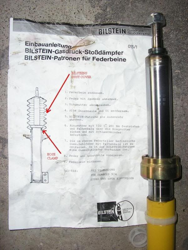

Where these meant to come with a special alrger style accordian shaped dust cover...or is the picture and instructions generic and the 924 wont use a dust cover??
im guessing according to instructions that those two parts above old monroe are removed (as they dont fit the larger diamter of the bilsteins monotube)
1979 NA

PostPosted: Thu May 07, 2009 8:00 am    Post subject: Reply with quote
I had to buy dust covers separately.

got a good cheap source min..or pretty much anywhere will have them?
also am i right in just removing the "old dust cover" and the "old bump stop" as shown above my monroes in the pic?

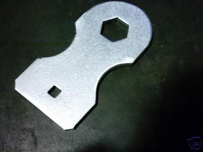

is there a special tool fopr tightening that ringnut to 120Nm ?

PostPosted: Thu May 07, 2009 11:29 am    Post subject: Reply with quote
Mine came with blue accordian dust covers.

PostPosted: Fri May 08, 2009 12:01 am    Post subject: Reply with quote
Yes.
Scorpio wrote:
is there a special tool for tightening that ringnut to 120Nm ?
Yes, a giant pipe wrench and a big table vice. If you want them to be special tools, apply a Porsche sticker to both and light two $100 bills on fire.

PostPosted: Sun May 31, 2009 7:19 pm    Post subject: Reply with quote
$100??? i Paid $20 for the tool delivered to my door off ebay... made the job a hell of a lot easier!
link is here
http://cgi.ebay.com.au/VW-Volkswagen-36mm-axel-nut-removal-tool_W0QQitemZ110394672122QQcmdZViewItemQQptZAU_Car_Parts_Accessories?hash=item19b40903fa&_trksid=p3286.c0.m14&_trkparms=66%3A2|65%3A1|39%3A1|240%3A1318|301%3A1|293%3A1|294%3A50
Local suspension places wanted $40 per blue dust cover...so i emailed the seller of the bilsteins and he found mine....for free!
Confirmation that the rears (bilstein) for early 944 fit the 924 bolt !

PostPosted: Mon Jun 01, 2009 12:02 am    Post subject: Reply with quote
Why are you using that tool to swap shocks and struts? That is for removing the castle nut on the rear axle (300+ foot pounds). Are you re-furbing the drum brakes at the same time?
I thought you were talking about removing the collar from the old front strut, that's where you use a pipe wrench and table vice.
Joined: 05 Jul 2007
Posts: 1957
PostPosted: Mon Jun 01, 2009 12:07 am    Post subject: Reply with quote
oops miscommunication....i put new shoes in the drums while i was at it
One of the old front strut gave me hassle to remove that big nut....so i pulled out the angle grinder and helped it to relax
Somehow managed to Ruin very little thread..i then cut 4 grooves in the old nut and used it as a big tap and die for the little bit of thread i stuffed...worked a treat!
