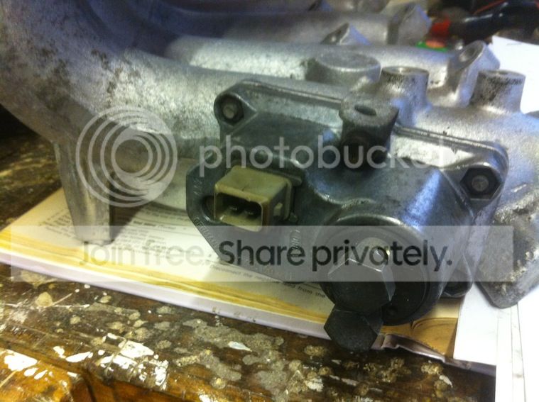

Hello all,
I just got a 1976 924 and am currently putting it back together after replacing the head gasket, belts and water pump.
I can't seem to find the correct mounting point for the bracket on this wiring harness next to the auxiliary air valve. I tried screwing it on with the same bolt which the three thinner brown wires are mounted with. I can't tighten that bolt though when I put the bolt through that bracket for that wiring harness.
On the three pictures you can see me pointing to that wiring harness bracket I can't find a mounting point for and also two other pictures taken from a different angle.
Any input would be greatly appreciated!

Hello Philip,
You’re looking at the right place.
What is missing though is the L-bracket witch originally is held by that top bolt of the WUR, and carries the wires on its other side.
Example by g00gle:
Tip: Hold down one of the copper eyed wires by a bolt in the AAV's 'feet'.
HTH
