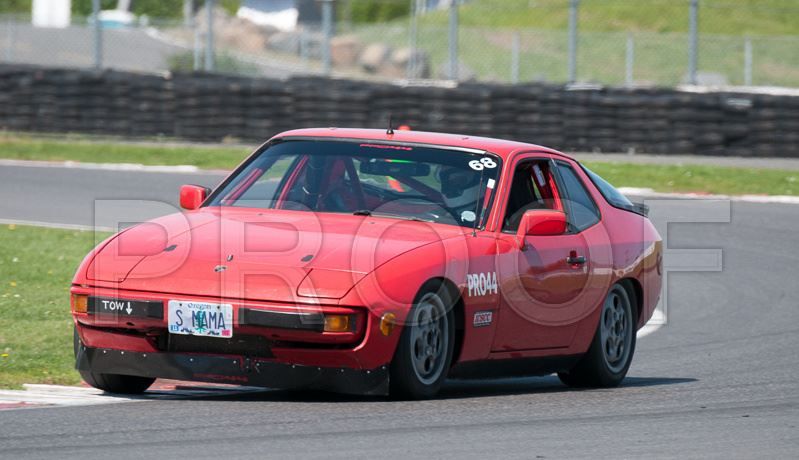

Got it. I always just set the toe to -1/16-ish and then it goes to 0 or a little toe out under hard braking. I'll have to look into this little device though. I like the cornering attitude in Rasta's pic. Nice, square and flat.
Not gonna get it with just a castor brace. S-Mama has 450# fronts, 31mm t-bars, and M030 ARBs. Did I mention Koni Sports?
