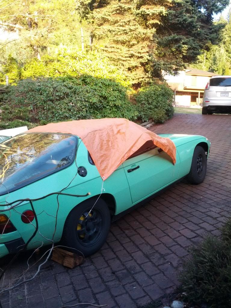

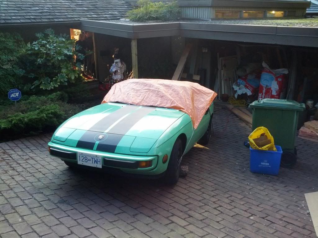

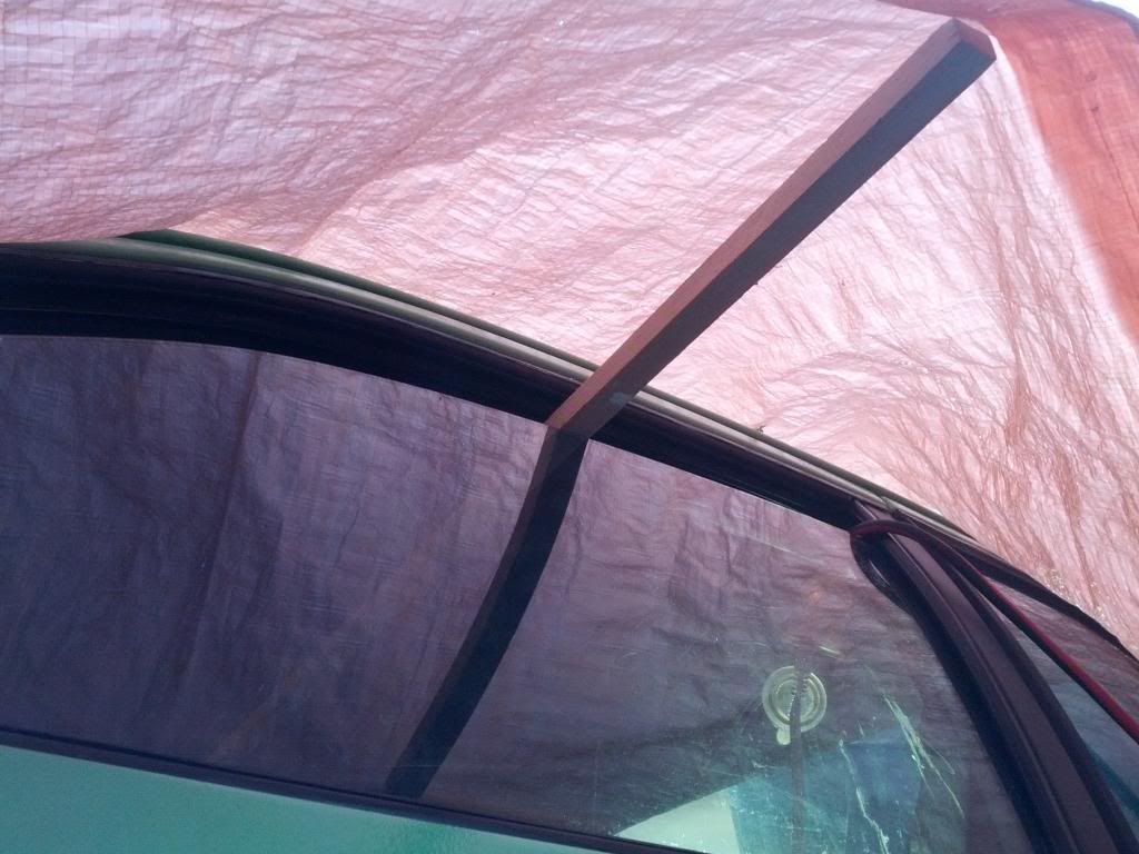

The garage is full of lumber so I was unable to put my car under cover, so I brought it down the driveway as much as I could so that I could reach an extension cord inside. I removed the drivers seat and put that in the extremely warm and dry laundry room where it will stay for the next week or so. The little pool that was by the pedals managed to soak into the carpet (don't fret, it was a very small pool) so I vacuumed the carpet a little (not sure how much that helped). I checked under the carpet and there weren't copious amounts of water under there so I didn't feel the need to pull the carpets. Instead I put a very warm blower heater inside the car and opened the windows an inch to let the moist warm air out. Since the car will be sitting with the heater on for a few days and it won't be under cover, I put a tarp over the roof of the passenger compartment with a long piece of 1x1 spanning the width of the car (and some more) to tent the tarp so that the air could still escape relatively easily. I'll keep the car like this for a couple days and this should dry it out pretty well.
Let me know if you know of anything else I could do to ensure the car gets completely dried out.
