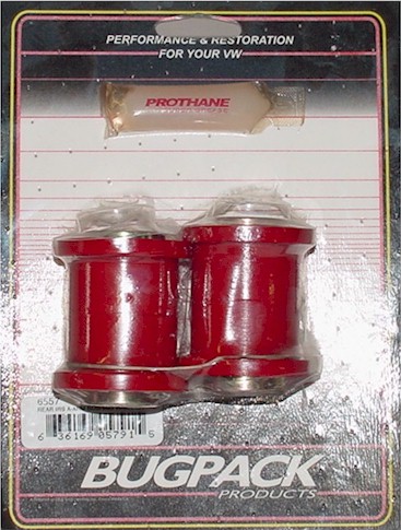

Cheapest for rears. That Empi part# is a set of 4 bushes and 2 tube inserts to do both sides.Shipping is a rip and they don`t have the rabbit front bushes.

Pretty sure going by the websites that list them under rear suspension. Cant find which bookmark now, but one site had them alongside the bugpack # 6557, rear A arm bushes.

Prothane # 22-201 fits A1 chassis FRONT CONTROL ARM. The front tube type inserts and the rear pin bushes under the clamp both on the FRONT control arm. Doesn`t include any rear suspension components as that is all VW Beetle.
In that link the guy has the 944 ALUMINUM rear arms, obviously different to our earlier pressed steel ones. So should fit Shaggy like a bush in a hole. Doesn`t Red, ya S, have ally arms?

Looking at that thread, it seems our trailing arm mounting bolts might be different than the Bug parts. . .ours are M12. I would double check that before buying the bushings.

Quite sure though that you and the PET are correct with the M12 bolt. Know what the 17mm VW bolt looks like, the head recesses into the housing. Since we all know the 924 uses VW rear arms assumed the bushes and pivot were the same also. Can`t find anything but hard bushes and bearings to fit 924/44s. 911 bushes may fit but too exy to gamble on.
Am however willing to risk a set of the VW ones to see if they fit our arms. Hoping some inner metal sleeves machined to suit with 12mm ID may do the trick.

VW bushes do have a 22mm bore hole, well 22.4mm actually. A spacer is needed to install these in our 924 steel arms with the stock 12mm bolt.
Problem solved:
