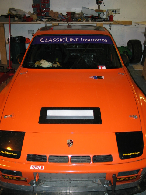

I am building a top mount intercooler Carrera GT style. Using a GT hood scoop.
It will drag cold air on to the intercooler, but the hot air can't get out. Has anybody thought about putting a vent next to the hood scoop to let hot air out?
Or is there a better way to get the hot air out? I don't care much for the looks, its for my race car.

Regarding the exit for the CGT intercooler, it has to flow down and out under the RHS footwell. The lower belly pan assists with this, as it has the reverse of those hood vents on the bottom of the pan.

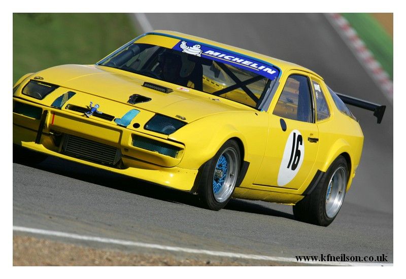

As to the original question, I would say that I think it was simsport who had tested and implemented a reverse hood scoop on his car to good effect. Basically, instead of a bunch of smaller louvers, he made one large one just aft of the headlights.
You may be thinking of Steve Bassington's car, which was specifically set up as a low pressure duct for the intercooler, not quite the same intended effect as these louvers, which are designed to evacuate heat from the engine bay.
Steve's car:
Simon's car:
