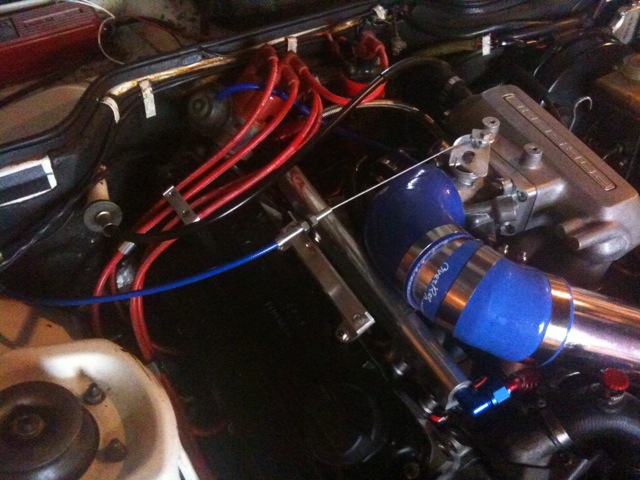

I did the same thing for my Weber TB install... pretty blue throttle cable... Made up a new top piece for the TB and also the mounting piece that bolts to the valve cover. Does the job.

Well I have the throttle and choke cable done!! I have the Fuel and vacuum lines done!!! Now I am waiting on the new inline low pressure fuel pump. Here are some pics sofar.
