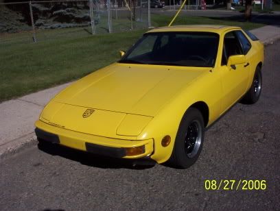

PostPosted: Fri Apr 13, 2007 8:23 am    Post subject: Reply with quote
my freind has a 1993 saab 900, and our rims fit eachothers cars, so since my car is not runing at the im leting him ride around town with my rims on his saab, and i know he couldnt smoke the tires with that saab. besides i like the look of the 8 spoke rims, well at least when they have the fuch rim paint job.

PostPosted: Fri Apr 13, 2007 12:50 pm    Post subject: Reply with quote
Me too...
