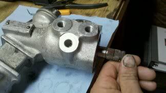

The next step is to remove the pinion box cap. Before you do this you must mark the relation of the cap to the steering box, and the relation of the pinion to the rack. I did the latter by first extending the gearbox side of the rack to an exact inch from the housing.
Then mark the relationship of the pinion shaft to the cap.
