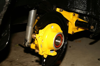

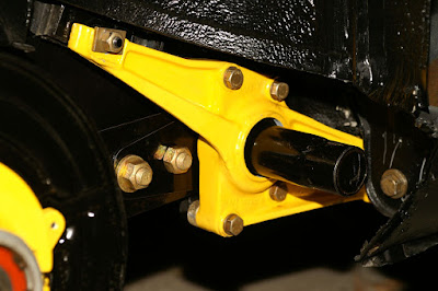

Some progress tonight
On Monday I was able to get the torsion bars pretty close to the right settings thanks to a template that Vaughan provided, plus the tip from ic932. Of course, I won't know for sure until the wheels are on and it's sitting on the ground, but I'm optimistic.
Tonight, I hung the torsion carrier, installed the trailing arms and also the shocks. If all goes according to plan, I'm hoping to get the hubs and rear wheels bolted up tomorrow!
I only had two minor issues with the install. When I first attempted to hang the torsion carrier assembly, the big honker bushing on the LHS torsion cover was hanging up on the inner bolt hole, which apparently had gotten distorted a little when he-who-shall-not-be-named ripped off my five lug suspension. A little creative manipulation with an air chisel hammered it back into shape, and then with some grease for good measure, it slid right into place.
The second minor issue was that the inner trailing arm bushings -- where they attach to the torsion carrier -- had to be surfaced a little because they were just a hair too wide to fit into the bracket. Again, some creative grinding took care of that! Otherwise, everything went together fairly easily.
As a side note, I had previously taken ALL of the suspension hardware and media blasted every single bolt, nut, washer, and spacer, and then had them Cad DiChromated. It sure is nice working with like-new hardware! Also, you can see a few chips in the yellow hardnose paint. Most of that is from meathead me banging things around while assembling or installing. Once I have everything adjusted correctly, I'll probably go back and touch up all the little nicks. And FWIW, the flash on my camera makes the epoxy primer on the chassis look a lot glossier than it does in person. It actually has much more of a satin appearance in person than the photos depict. _________________ erstwhile owner of just about every 924 variant ever made |

pocketscience
Joined: 23 Apr 2006 Posts: 1650 Location: Sydney, Australia... mate!
Posted: Fri Aug 21, 2009 1:34 pm Post subject: |
Very nice Dan. Love the color-coding.
Looks like you did have to add a few washers on the lower rear shock mount.
Can someone flick me the template? I'm going to be putting all mine back together at some point and getting the torsion bars right is scaring me.
