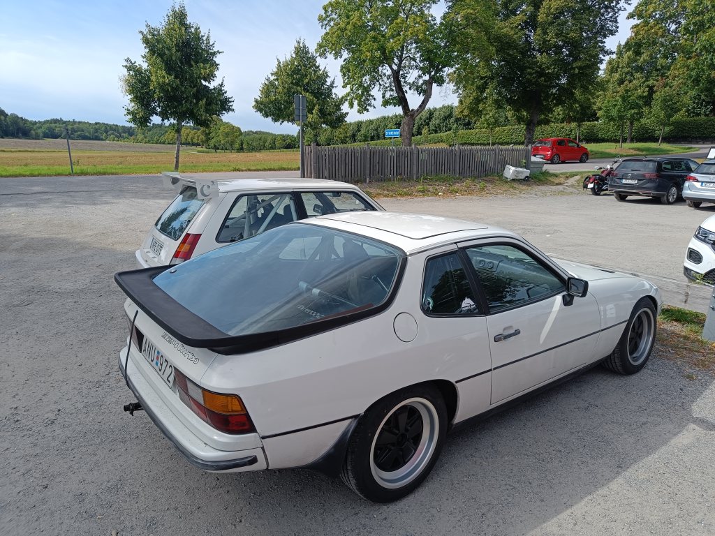

Well this wasnt a very well uppdated thread Last year got lost because the engine was blue smoking alot when it was finally started up, after tearing down alot of stuff, including removing a piston (shitty job) removing the head (also a shite job) and the conclusion was that there was a score in one of the valve guide bores, from either when they were pulled out or in. The company who did the engine work fixed it, but it sucks since i lost a driving season pretty much.
Anyway, its on the road now, and I had a few test drives, to continue to get some driving time on the engine. Ive also had a few fun test drives on twisty roads to try the new GAZ gold suspension.
Current status
Engine:
I had some issue with a weird rev hang when it got warm, disconnected the decel valve and it disappeared , very strange.
It pulls really well, and it will not be very long run in process, i mean 0,7 bar is part load now that i can run 1 bar of boost:) The last oil i took out was crystal clear, so i think not much more will happen from now on.
The fuelling which have always been rock solid since 2009 or whatever year i started driving it properly have now jumped a whole step in AFR, which means its running pretty rich. With the boost line to the wur unhooked (ive had that before aswell) it runs 11.-11.4 at full boost 0,7 bar and 13ish at cruise, so i will have to sort the cruise fuelling at some stage.
I will keep it at the standard 0,7 bar for a while, its still very strong, and i want to have everything under control before I let it back on higher boost
Suspension:
Really like the new dampers, i was afraid they would be to much for the road, but actually they are better at handling bumps then my old less racey dampers. Its still on 350lbs springs, but I feel that the 425 that i also ordered could work as good, ill test that later, its a bit fiddly since i need to put the springs on the rear dampers to balance it, but i have them aswell. The only strange thing is that the rear right damper sounds weird, like a bicycle pump, trying to get some input from GAZ.
New brakes:
The new brake setup is working really well, nice pedal feel and good power modulation. The Ferrodo DS3.12 are pretty brutal when they get hot though, a bit to much bite for road tyres, lets hope it fits my wider track tyres well . However i might need to get some better rear pads to balance it up, im not sure what to get since i have to look at a mixed setups with different manufacturers.
So after fixing a few small issue like a loose boost pipe etc, hopefully i can continue to accumulate more driving and test things out a bit more. Not sure that I will have time to try any track or so this season, otherwise I will do that in the spring instead, im not stressing it. Im just glad that i can have fun on the twisty roads, which i have plenty of around here.

| The intercooler is very nice and stealthy. Really nice looking car in general. |

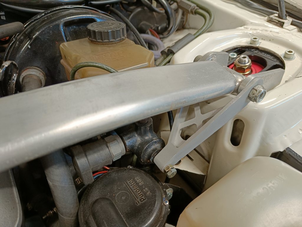

Many have probably seen it on my IG or similar, but heres the pics to keep continuity in the thread.
As a fun little side project I made a bracket to stiffen up the master cylinder, it moves a little bit under really hard use, and why not try 3D printed aluminum at the same time to get a feeling on how it works for consumer use. It also fits well with the improved braking feel of the Boxster calipers.
So I did a quick and dirty scan, not great but without any prep, but good enough to design a few plastic printed iterations and the order the alu printed one. Sucessful so far with the garage testing, it greatly reduce the movement with really hard brake application, but since its winter i only tried it in the garage. The small flex that is still there is in the strut mount bracket, so quite diffcult to do anything about, the strut bar mounts arent designed for the twisting force.
Im really happy with the parts so far, so i will probably do more metal printing in the future, would be fun to do stainless aswell !
Made it in fusion, the scan is reduced to improve speed as Fusion dont like big meshes.

Joined: 14 Dec 2004 Posts: 1798 Location: Chicago-ish
Posted: Thu Dec 05, 2024 9:25 am Post subject: |
That is cool! I missed your IG _________________ 1980 931 since 1989

Posted: Tue Mar 18, 2025 11:06 pm Post subject: |
So cool! Can you sell me one?  _________________ ---

| kondzi wrote: | So cool! Can you sell me one?  |
Its very specific though, for this brand of strut bar, otherwise i would have probably ordered at least two  _________________ 1980 924 Turbo

Posted: Wed Mar 19, 2025 6:58 am Post subject: |
| Cedric wrote: | | kondzi wrote: | So cool! Can you sell me one?  |
Its very specific though, for this brand of strut bar, otherwise i would have probably ordered at least two  |
My strut bar is not yet there. Still need to finish the intake and then I will fabricate strut bar. So for me it still makes sense. Surely I can "borrow" the idea and make similar thing on my own, but if it's already there... Credits for the idea/design
Anyway, I still have time, but need to check my M/C if it will work, as I've replaced the stock one with one from Mercedes G'ish (25.4mm) and changed form the X-setup to Front/Rear. _________________ ---
