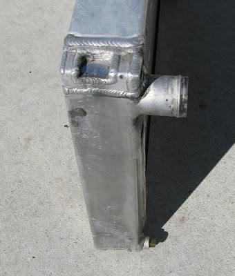

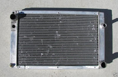

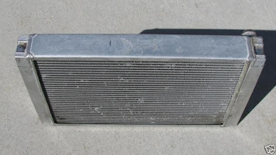

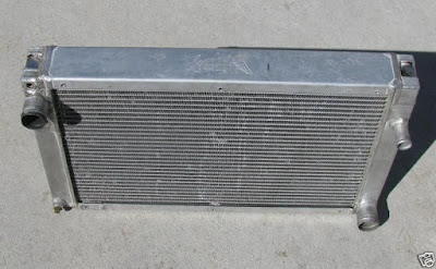

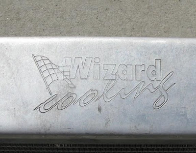

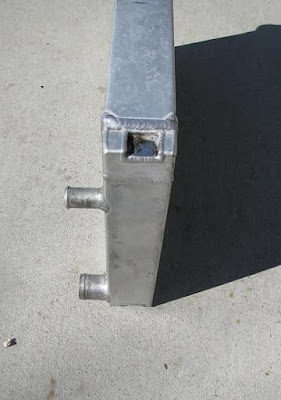

Snagged a Wizard Cooling 951 Alu racing rad over the weekend:
