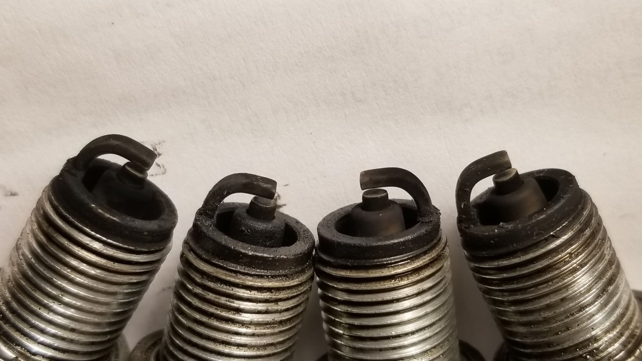

heres a pic, back to front order:
the #3 was slightly wet as there was some left over soapy water from my testing.

Ignoring 3 and looking at 4, its a lot more carbon fouled, but still firing at least at times, than 1 and 2
Did you do a compression check? something isn't consistent over the 4 cylinders
I would probably put in a new set of plugs, run it, and try again to read. Plus that compression check
Also concerned if you found the one injector had an issue how are the others? _________________ 1980 931 since 1989

The one on the right has some small shiny bits stuck to its electrode, what material are those little stuff made of? _________________ Supercharger and EFI kits

Get new plugs or at least burn them clean with a propane tourch (heat until electrode is cherry red, brush off).
Run them untill it hessitate, shut down (on the side of the road), pull them out immediatly and check how they look. _________________ /Magnus, Stockholm Sweden

If your screwing around near det limits I’d ditch the projected tips and go with br8es or maybe even 9s..
9s have been fine in my car and I think crsr runs even colder plugs.. _________________ 80 Turbo - Slightly Modified |

Judging by how the plugs look I would go with hotter.... _________________ /Magnus, Stockholm Sweden

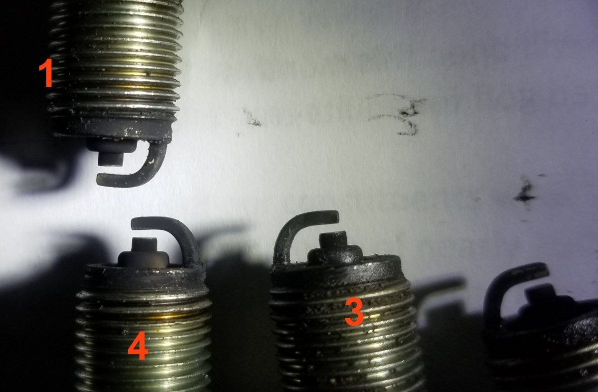

As for plug 4 I think its the side of the plug, I noticed one side of the plugs has more carbon than the other, heres a pic with 4 flipped over. I think they all look close enough that they don't account for the missing/hesistation at idle, at least not enough to have NO power off the line.
But also if there was a leak at#4 it would be leaner not richer right?
