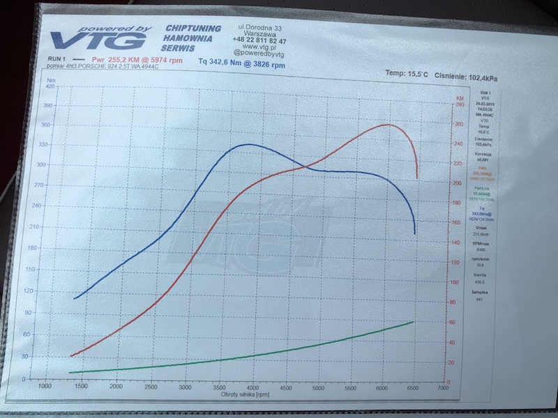

In the meantime, as I was recently super busy traveling all around Europe and Central Asia found 15 minutes for Dyno Run Just wanted to ask how much money I need for that, and when it would be possible to do the pull... But it just appears they got an empty slot, as someone did not appear, so straight from the road...
https://youtu.be/_HDn45fwVc8
255HP and 342Nm

On the wheels?

Cédric wrote:
On the wheels?
I suppose not on wheels... not used to reading dyno charts - that’s my first dyno pull ever
