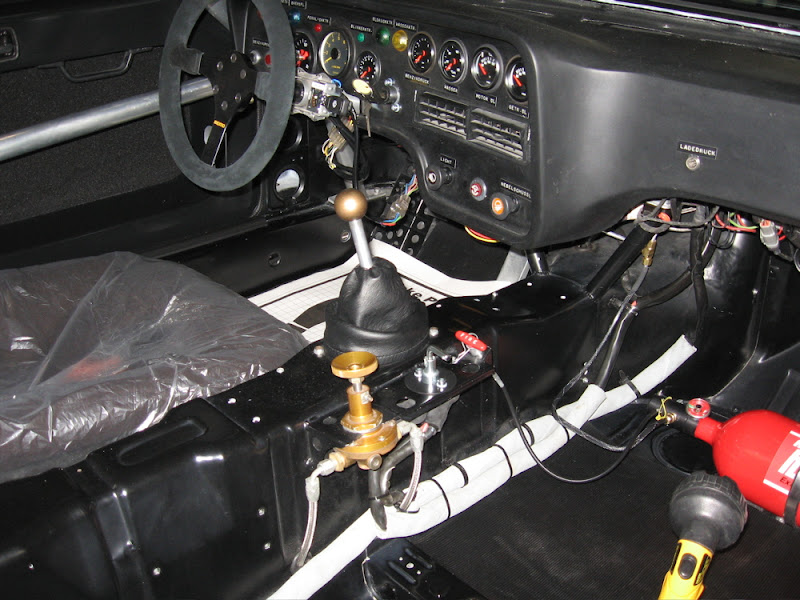

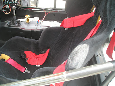

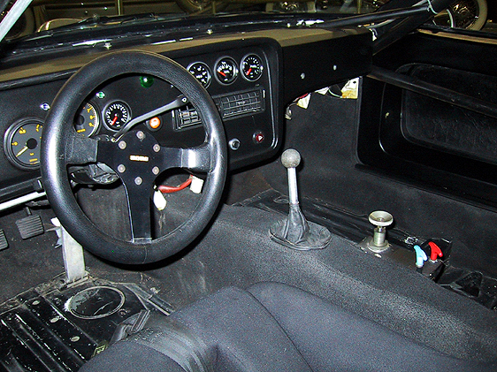

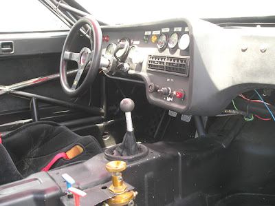

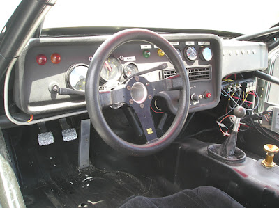

Nein37 wrote:
Almost forgot. Does anyone know where to source a boost controller setup like the ones in the GTR cabins?
Like this one? This is the #87 car that always shows up for sale in Las Vegas:
Here is the Hugo Boss car:
And the Canon car:
Don't know where to find them, but they sure look cool.
