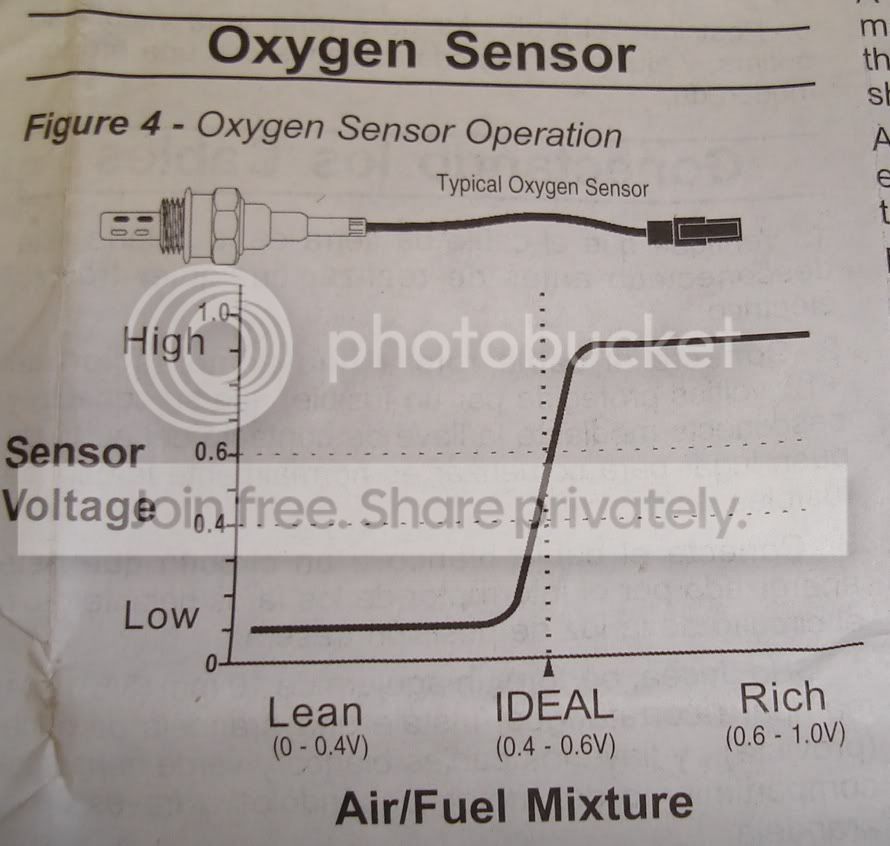

I purchased the narrow band AFR gauge from Autozone for $24.00 dollars.
It is a Sunpro model and there are only four wires coming out of it (red, black, white and green) so the wiring is fairly simple. The red wire goes to a fused +12V key on. The black wire goes to a good ground on the engine. I tried using a chassis ground above the fuse panel but when I turned on the lights the gauge reading would change. To fix the problem I ran a ground wire into the engine compartment and connected it to the ground at the coil. There is a white wire that simply connects to any wire that has carries 12volts when the lights are turned on. There are quite a few wires behind the gauge panel that run to various light bulbs that turn on when the lights are on. You just need to tap in to one of those wires. Finnaly, the green wire from the gauge connects to the oxygen sensor signal wire. The oxygen sensor signal wire that goes into the lambda control unit under the stearing column is a thick green shielded wire. The inner wire is the one you need. When you splice in just make sure the outer shielding wire gets reconnected. Here is the wiring diagram that came with the gauge.
This gauge has been extremely valuable. It is very easy to monitor what is going on in the engine and make sure the afr is not getting lean under boost. _________________ 1980 - 931 |

Posted: Tue Dec 02, 2008 4:26 am Post subject: |
Interesting. I would have thought that the splice would alter the resistance, and hence the reading going to the control unit. Have you verified the accuracy of the gauge with an independant measurement? _________________ Toofah King Bad

Posted: Tue Dec 02, 2008 8:25 am Post subject: |
That is a good question Rasta Monsta. I decided I better ask our electrical engineer about this one. He informed me the Oxygen Sensor is a voltage source that varies between 0 and 1 volt depending on the oxygen content in the exhaust. The lambda control unit measures this voltage and responds accordingly. When the AFR gauge green wire is spliced into the oxygen sensor voltage wire it does not affect the output of the sensor. It only measures the voltage similar to the way a volt meter would. By the way if you don't want to buy a gauge or install one you could simply hook up a volt meter to the oxygen sensor and measure the output voltage. The output of a narrow band oxygen sensor looks like this:
Just to be sure I did an experiment on the car. I started the car, let it warm up and looked at the frequency valve duty cycle using a scope. The duty cycle was right where it should be hovering around 50%. I then disconnected the AFR gauge green wire from the oxygen sensor wire and there was no change in the duty cycle. This assured me the AFR gauge was not affecting the output from the oxygen sensor to the control unit. _________________ 1980 - 931 |
