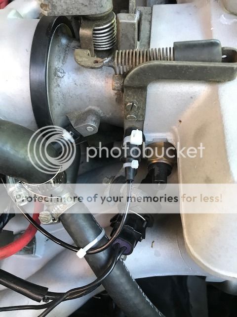

I posted about installing a boost gauge here:
https://www.924board.org/viewtopic.php?t=44208&postdays=0&postorder=asc&start=15
My car is a bit different...it's a 1981 car with a 1980 engine/transmission...then the S2 intake/boost pipe (subsequently replaced by intercooler).
I connected my boost gauge to the boost sensing port on the S2 intake.
So not sure what to say for S1 installs.
Pics on the thread above....but here is the specific port.
Gauge indicates boost and vacuum. It's nice to see both.
