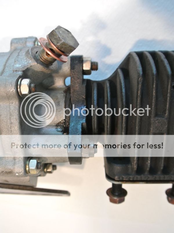

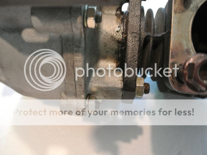

I removed the waste gate today. Not as bad as I thought it would be, but it did take a while.
I took a bunch of pictures to document the process and will post those next.
Can't really tell much from the pictures below of the WG...but between the hot/cold side the gasket seemed a bit gooey. Seem like if there was a big leak there it would look different.
Next step will be to disassemble the WG and check it out. I was thinking about criss-crossing some straps across the top to prevent the spring from going flying.

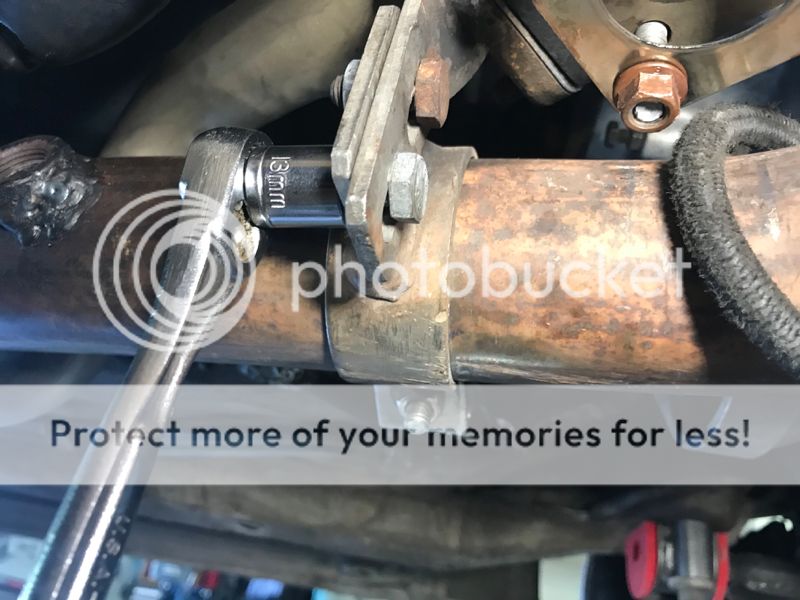

Step 2
I did this out of order. The book says "detach and remove bypass line between exhaust manifold and waste gate."
I wasn't clear that meant the J pipe. I disconnected these parts:
And then I realized they were talking about the j pipe. The good news is that the nuts too little effort to remove.

Step 3 - remove J pipe
These nuts were easy to access and not super tight.
Used a long extension to loosen the nuts that connect the j pipe to the exhaust manifold.
Here's picture with the j pipe removed. Makes you think that the WG is ready to drop. Nope. Not yet.
