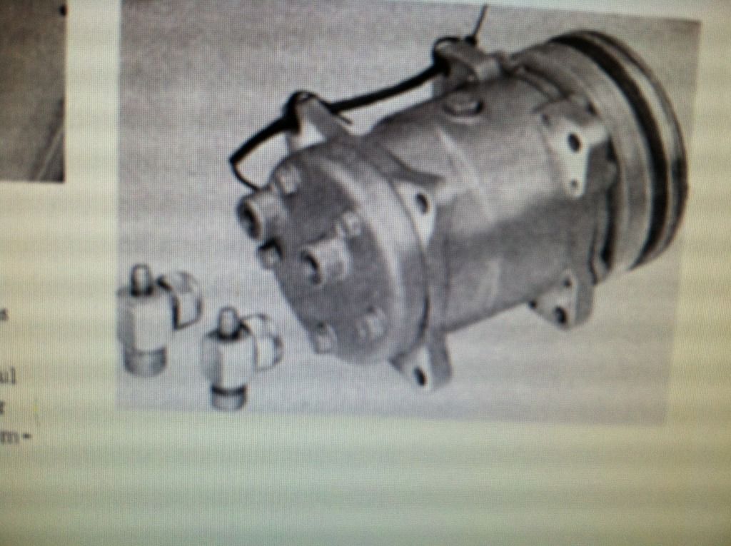

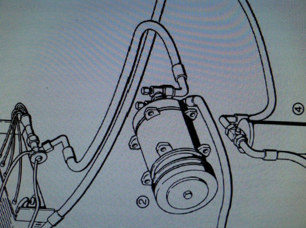

Here is a couple of drawings from the factory manual showing what the valves look like.
[/img]
Here they are on the back end of the compressor. They should be in a place where the gauges and hoses can be connected on for charging. I've seen some of the newer accumulators also having a low pressure charging port on the top, but that would be very easy to see.

Ah ok then I found them, there are two caps on compressor, these probably are the valves.
