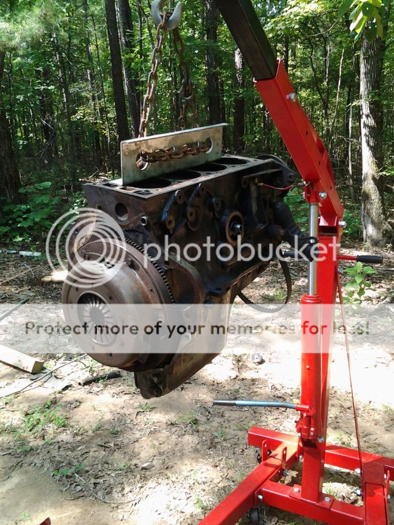

I guess it's about time I started a thread on my engine swap even though it is in the early stages. I bought a donor car and pulled the engine/tranny. I plan on using everything I can from the original car. I'm even considering using the master cylinder and booster from the Passat. They take up less room and if they can stop that big station wagon I bet the 924 would be zero problem. I pulled the engine with all the original wiring in place. I'll be running the factory computer at first, then later I'll probably at an APR chip. The stage one chip claims 205hp which should be a boat load of fun. I'll try to take as many pictures as I can. Sometimes when I get into working on stuff I forget to take the snap shots.
PostPosted: Sun Jul 20, 2014 11:47 pm    Post subject: Reply with quote
Donor car, I picked up this running and kind of driving 1.8t Passat for $500 because it had a bad comfort control modual and the owner couldn't figure out what was wrong. I took two wires, jumped out the starter interlock and drove it up onto the tow dolly.
Here's the 1.8t with all it's factory wiring. The original computer sits in a plastic box in a little cubby hole in front of the driver under the hood very similar to the empty spot the 924 has. I plan on mounting the computer in that empty spot.

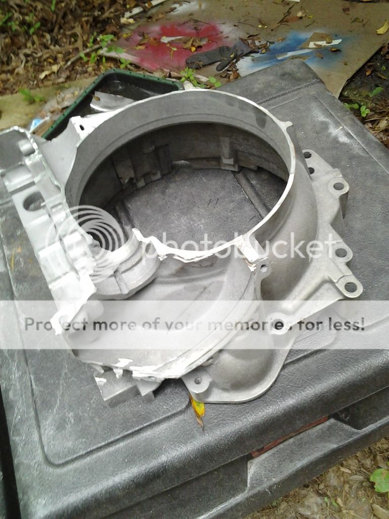

I sawed the Passat transaxle in half. It will require some more cutting and a little grinding to make a good bellhousing.

PostPosted: Mon Sep 08, 2014 11:07 am    Post subject: Reply with quote
I made the final cut on the bellhousing before it is sent to the machine shop.
