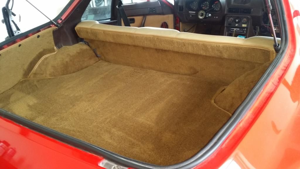

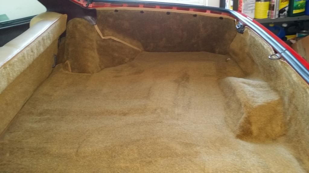

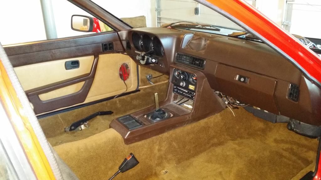

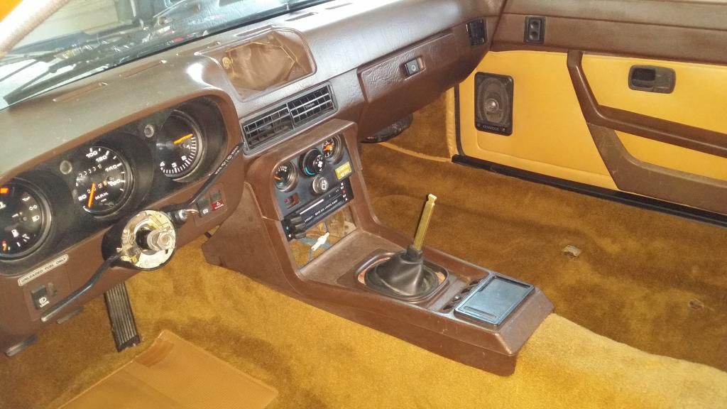

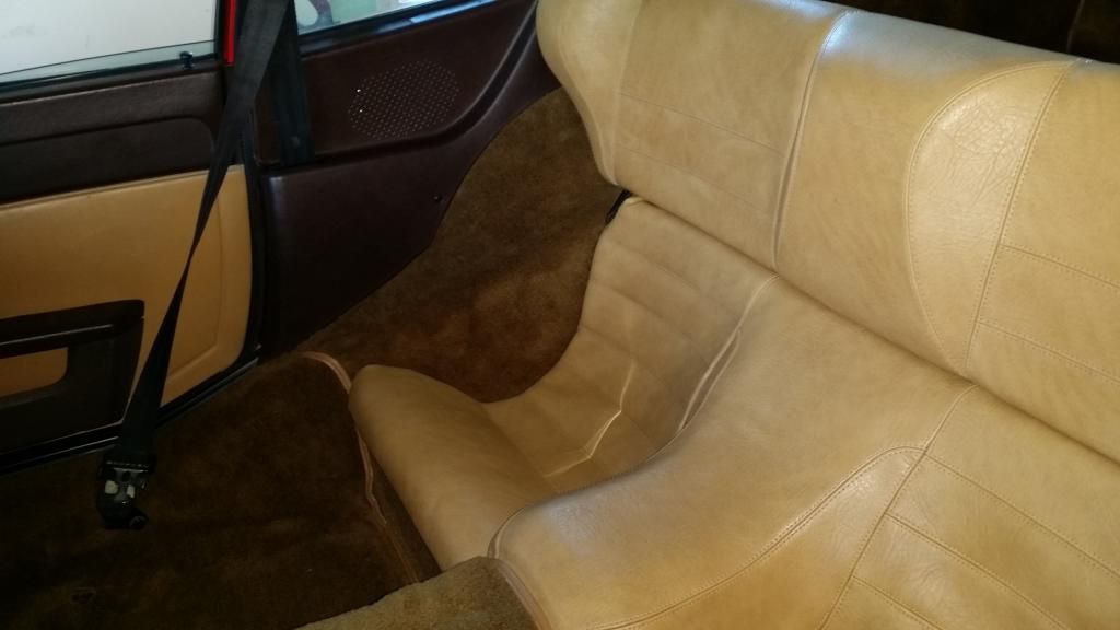

Made some more progress the past few weeks.
I put in the new carpets, center console, as well as all the interior panels, new seals, and rear seats. I also installed some new infinity Kappa's 4x6 speakers in the rear and will mount some in the doors as well.
The only things left to do inside is to install the stereo and amp, new "Porsche" embossed door cards, front speakers, front seat and steering wheel.
It's coming along nicely and won't be long before it's finished.
Ron
Here are some pics, (btw I have an extra carpet kit in same color that I'm looking to sell and will make a post in the for sale forum when I get a chance.)

PostPosted: Tue Sep 02, 2014 1:49 pm    Post subject: Reply with quote
Looking good!
Posts: 9080
PostPosted: Tue Sep 02, 2014 3:45 pm    Post subject: Reply with quote
very nice looking interior, look at that dash

PostPosted: Tue Sep 02, 2014 9:09 pm    Post subject: Reply with quote
Soooooo NICE !!!!

PostPosted: Tue Sep 02, 2014 11:52 pm    Post subject: Reply with quote
Man, that is one classy interior. Looks familiar.
Seriously though, it's good to see someone putting the car back together the right way.

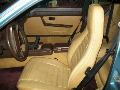

PostPosted: Wed Sep 03, 2014 1:56 am    Post subject: Reply with quote
Very nice, I wish my drivers seat was in that good of condition, but I still have a new pair of genuine sheepskin seat covers I bought in 89, lol.
I do want to get one of those armrest/cassette holders though.
