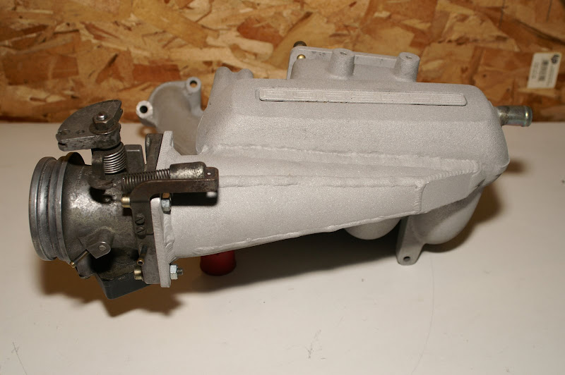

Flosho's custom built approach (from this thread):
-nick's modified / customized approach (from this thread):
My modified / customized approach (from this thread):
There are several others documented here on the forum, which you should be able to dig up with some searching...

I like all those approaches.
I do fancy having a go at making one like Ideola's with a spare manifold I have.

I have a man lined up already to do this.
Dan, any feedback on this set up?
PostPosted: Fri Sep 02, 2011 5:49 am    Post subject: Reply with quote
Sadly, it's not in use yet, as the Ultra Wide Body project is on the back burner until I complete the Club Sport. But it was fairly easy for my welder to fabricate, and I'm very optimistic about how it will function.
PostPosted: Fri Sep 02, 2011 12:26 pm    Post subject: Reply with quote
I also like the ideola manifold. . .might move the add-on portion up flush, though.

PostPosted: Sat Sep 03, 2011 5:31 am    Post subject: Reply with quote
If you do that, you'll have to rotate the throttle body 90 degrees and mount it sideways, along with fabbing up a custom throttle body bracket & assembly. With the TB so far forward, the diffuser plenum has to be down on the side of the manifold to avoid interfering with the closed hood, which is much lower that far forward than where the main plenum sits.
