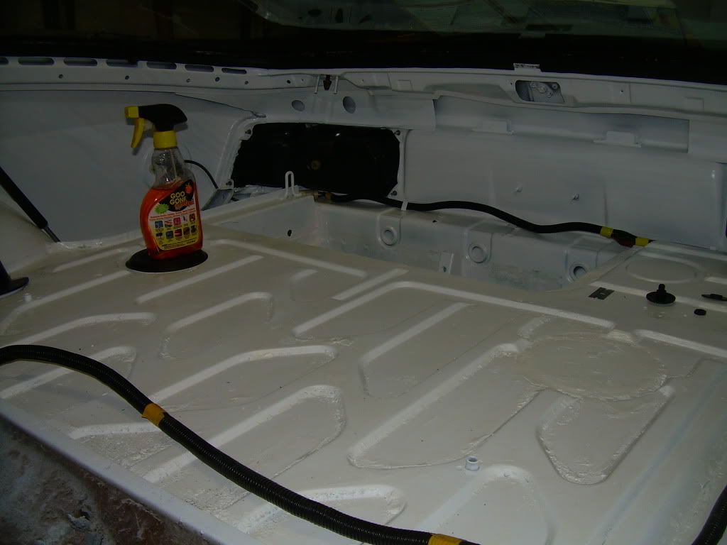

finished cleaning up and painting the boot.

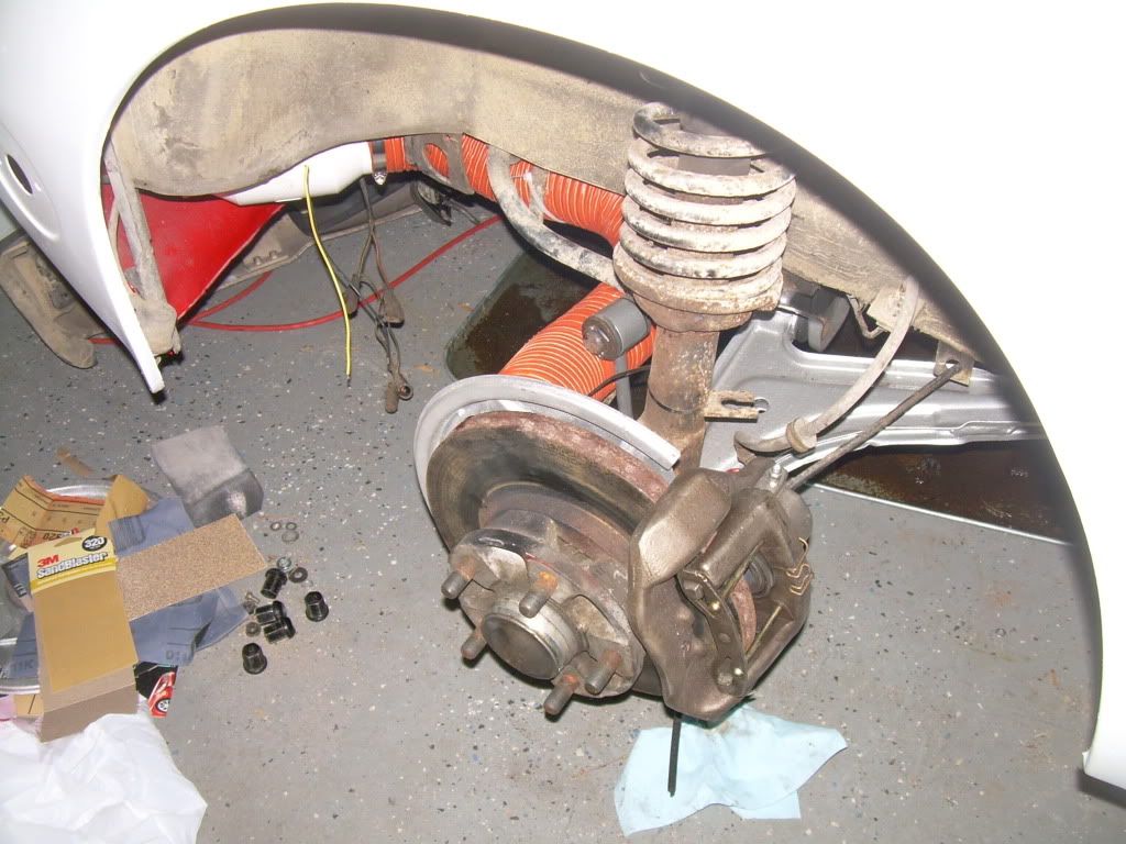

Have five lug (86 944) spindles on the front, trading out the entire rear torsion bar assembly for an 88 944's set up....this will take a while. Got a set of 29mm hollow sway aways off of e-bay (if it was from someone on here...Thanks!!)

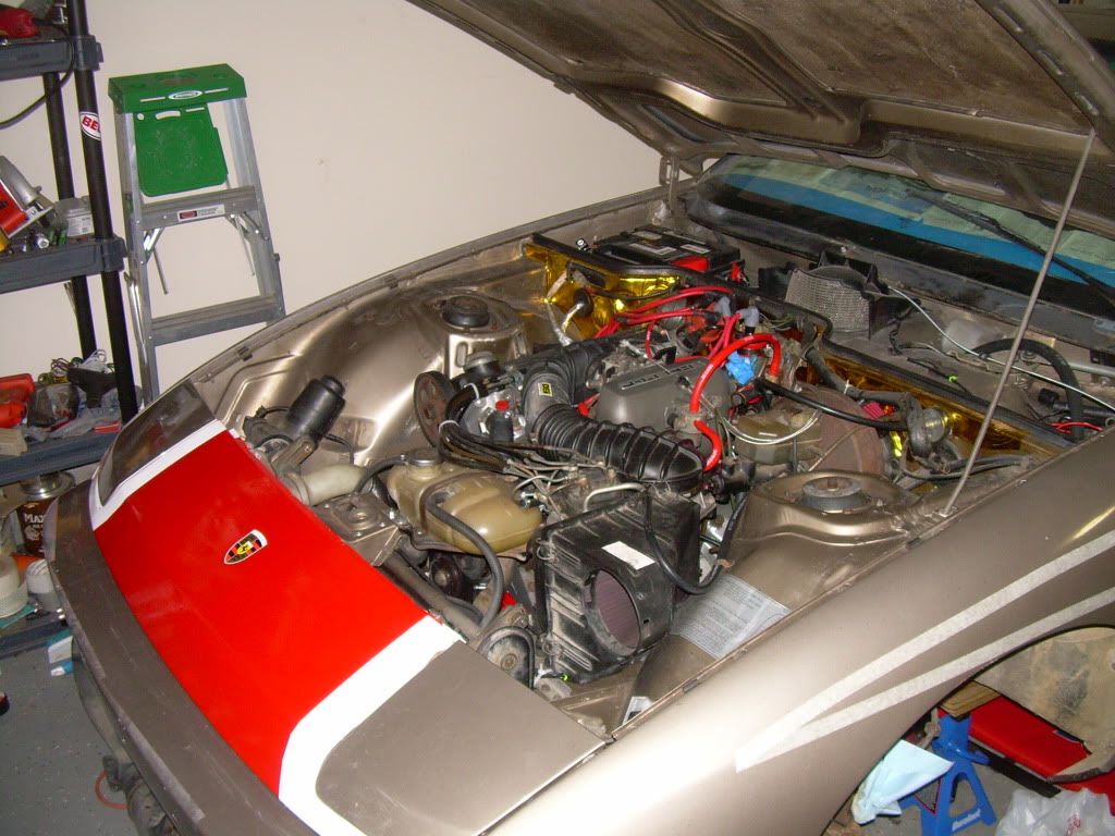

Painted the header panel to give a hint at what she will look like.....I will post pics later tonight.

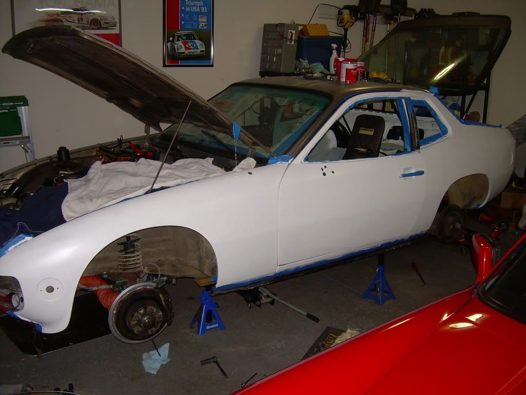

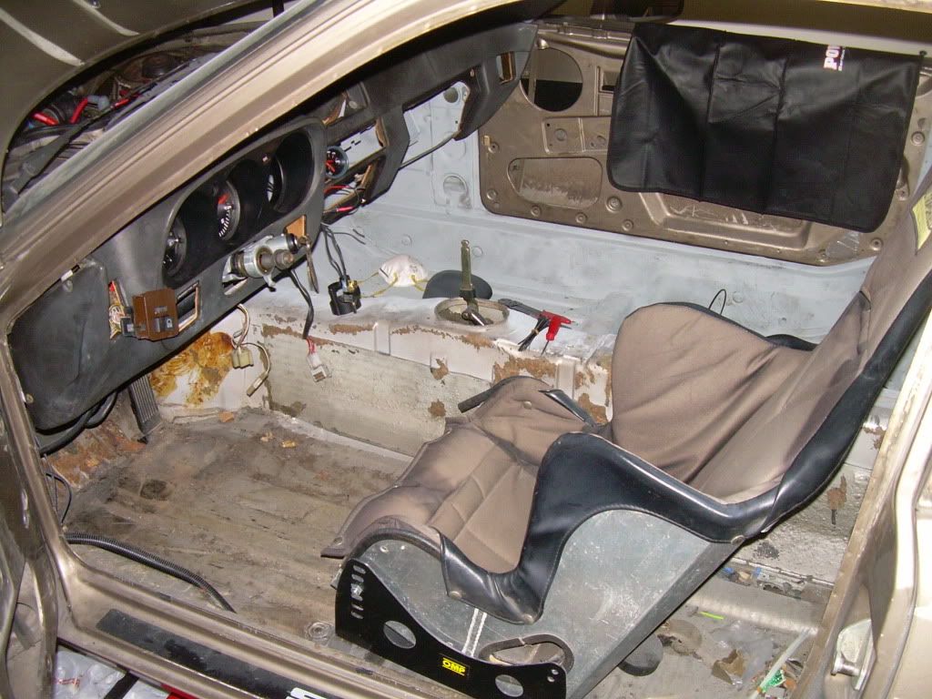

The interior as she stands...a complete mess
The "finished" boot
10 points if you can tell me the famous race car she is going to be painted as =-) The Porsche emblem is a sticker version they used on the 964 RSR's and RS's - thought it would give that track car touch

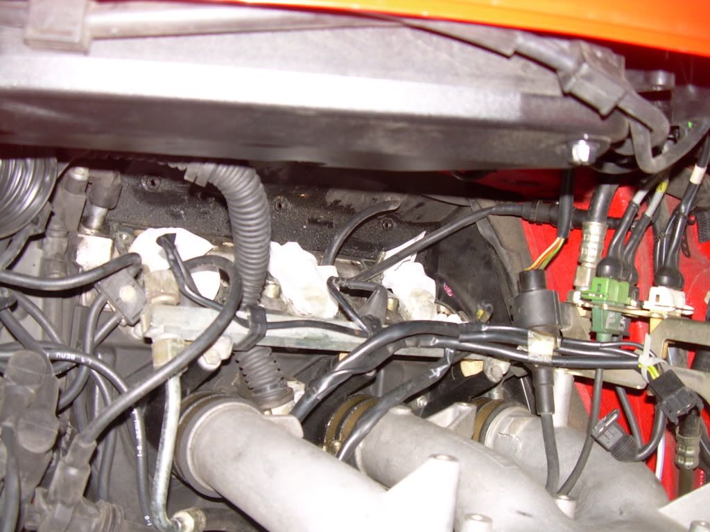

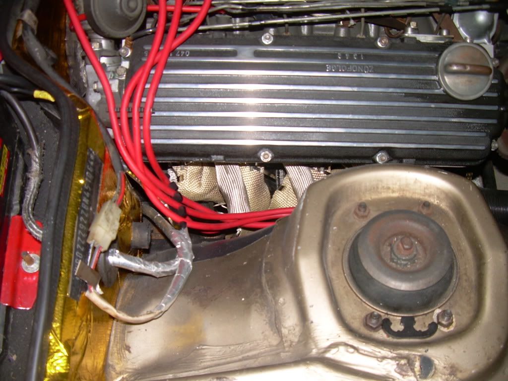

Heat protection wrapping on everything around the exhaust

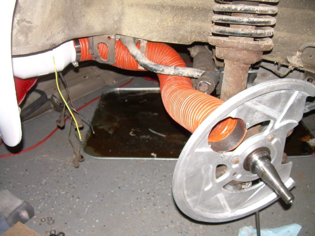

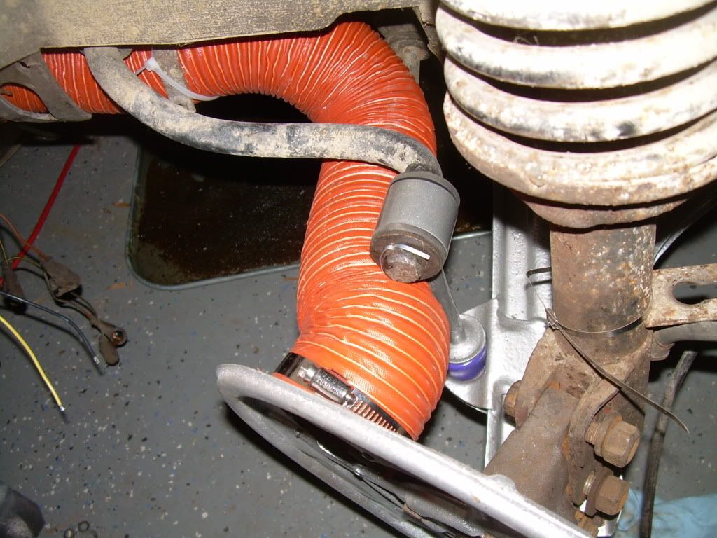

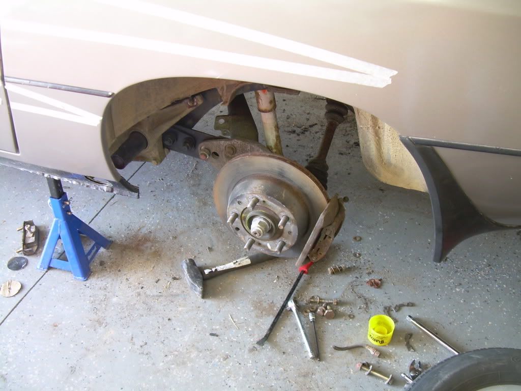

Right hub....powder coated a-arms, new bushings all around, new ball joint, new tie rod end....in the future there will be a very nice Ground Control strut in there with an adjustable camber plate, 400lb spring, and Koni adjustable insert.......just use your imagination =-) I do every time I look at her

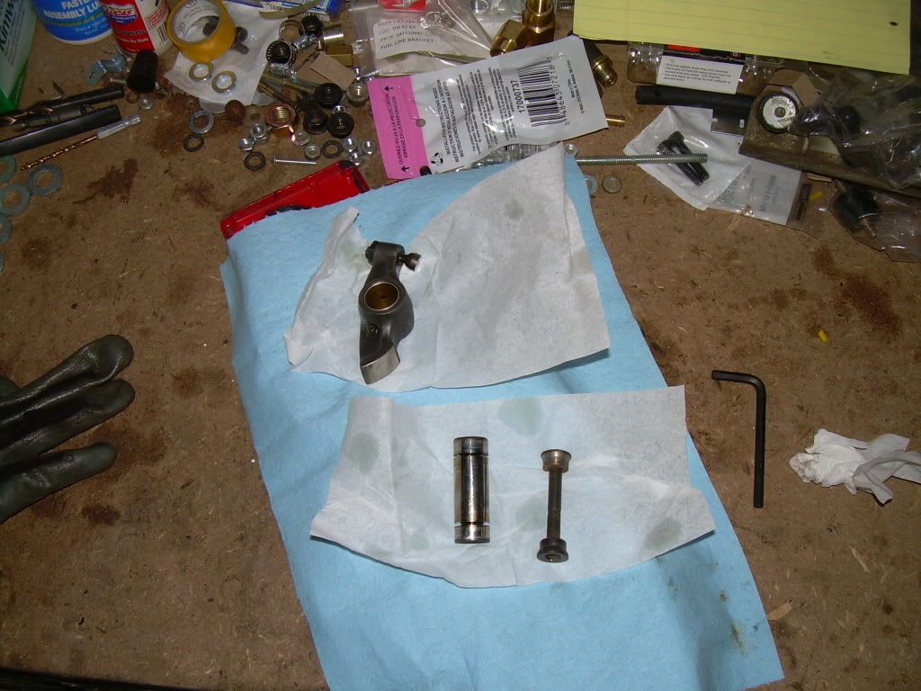

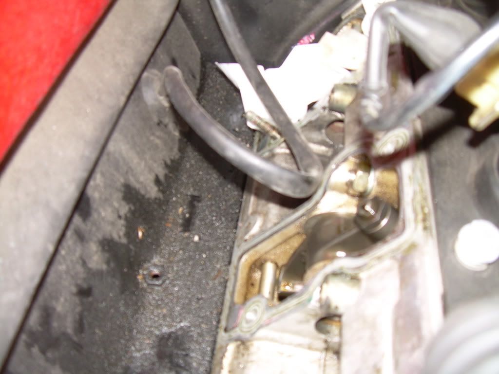

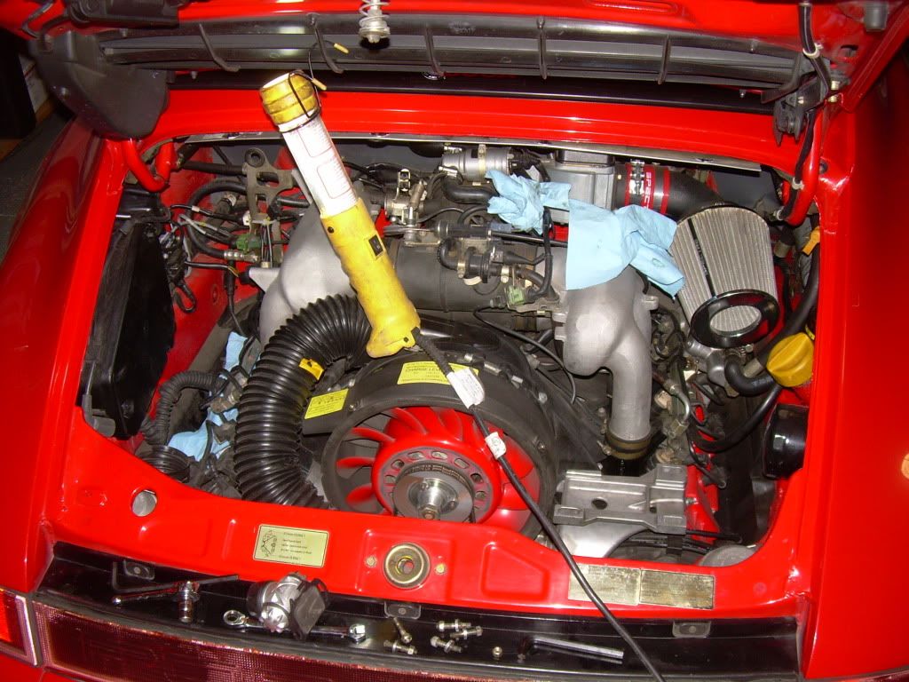

However, at the moment I am doing surgery on the 911. Going to the track this weekend, time trial at North Carolina Center for Automotive Research, and while doing my checks found quite a bit of oil in the engine tin of the left side of the engine. I have had this problem before, so I pulled off the valve cover and lo and behold, the rocker arm shaft was leaking. This is a fairly common problem on the 911's of any age. Porsche designed the shaft to seal with only the torque placed on the bolt going through the shaft to compress the shaft enough to form a metal on metal seal. As they wear, even the tiniest amount, they stop sealing. Oh and it is impossible to get a torque wrench in there with the engine in the car....... So it just takes some vigilance.....I seemed to have missed this one for a little while (bad p-car owner!!!)
I have decided to try and nip it in the bud this time with seals that Porsche used on there 911 RSR's and 935's. Of course, as with any rush order, not here on time and I will be rushing to get the car back together, fully prepped, on the trailer, and get on my to the track. Gotta love that motor sport addiction!!
Just some pics of the surgical site and the culprit....

Are you using the stock exhaust manifold on the 924? I had issues with heat and header wrap on the manifold log did not seem to work as well as the factory heat shield that wraps around the spark plug leads.

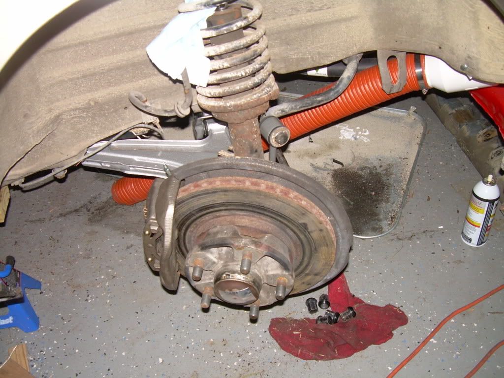

Finished with the left front hub assembly (take 2) - made sure the rotors are within specks - good all around, just a little rusty, finished with the brake cooling tubes + fresh air blowers. The Fresh air blowers are for marine applications so are water proof and will help to provide a constant flow of air. Got the idea from a 911 buddy and it works out very well for him. - The oil is not from the 924 - left over from an oil change on the 911 -
