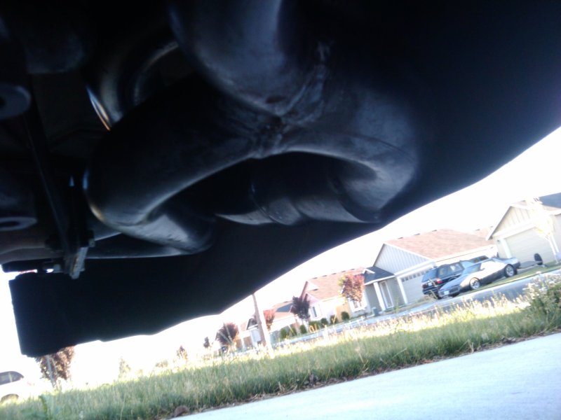

PostPosted: Sat Jul 24, 2010 1:02 pm    Post subject: Reply with quote
It was the stupid goddamn bursch exhaust. At 2300rpm the backfiring is vibrating the tail end of it and it is rattling the living holy hell out of the rear bumper. I FINALLY FINALLY reproduced it OUT of the car and caught it red handed!
Plagued me since I did the engine oil and exchanger seals. Never even occurred to me as it was in the same place it was. I didn't notice it was THAT tight.
Going to celebrate by driving it to work again tomorrow. The noise makes sense now.
Apparently when I turn hard left it bumped part of the bumper then holds itself up nice and tight. Once it does that it rattles the bumper and it flaps around like mad. Soon as I got the engine bay open i revved the engine since it made the sound, heard it from under the car but it was LOUD as hell.
Revved it and ran under the car, saw and heard it. Moved it and sure enough, sound was all gone.
"I'll be damned."
All that worry over something as simple as clearance on a bumper with the muffler. I can sleep at night now. I AM going to keep my appointment with german master tech though just so they can still scope everything out and flush the tranny for me - for the price they have, I can't turn it down, and hell, having a second pair of eyes to look it over and double check everything will be a good feeling.
I win this time!
