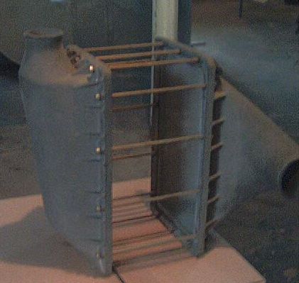

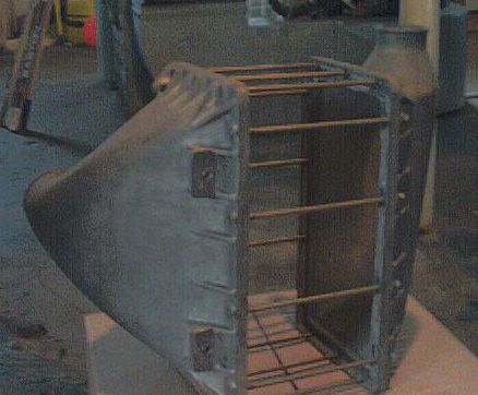

No, this is the exact original end-tank layout of the GTR intercooler. Peter Utzon used to have a pic of the conplete GTR engine together with intercooler on his site but no more.
I could make you one if you find the core. I bought the core from Dan (ideola).
Are you sure? Check this picture from the Freisinger site. http://www.freisinger-motorsport.de/porsche/uk/Porsche_Restoration_Detail/8.html
I think Peter Utzon is not that close to the original design as his pics show the turbo on the wrong side, ITB's ect which the GTR never had. Private teams may have developed their cars along this route, but not from factory. Peter does however show the dry sump pan, and it's Porsche part number. This alone i would guess is NLA
Steve

Only difference between mine and factory one is that lower end-tank is oriented to the other side (drivers side on LH drive cars). Otherwise it's the same.
Peter Utzon had few scans from GTR factory manual and there was a pic of the whole GTR engine together with IC. Not there anymore, just dead link.
The intercooler core on the Freisinger car is exactly the same as mine, even the stickers are the same. It's a Garrett AiResearch core.

Looking at that IC pic again it seems that Freisinger has put the IC core backwards when assembling the intercooler. There are arrows for boost and ambient airflow direction.
