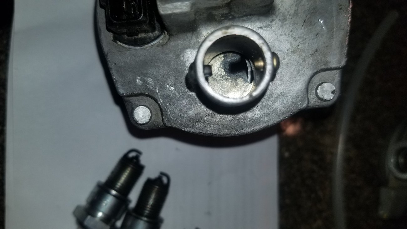

PostPosted: Tue Mar 16, 2021 10:11 am    Post subject: Reply with quote
CSV is not leaking
heres a pic of the AAV at 55deg, (car not started for a few days)
It was either this or a giant box of legos
MikeDanger
Joined: 21 Nov 2002
Posts: 636
Location: Denver
PostPosted: Tue Mar 16, 2021 10:52 am    Post subject: Reply with quote
Just tested the AAV, it works
