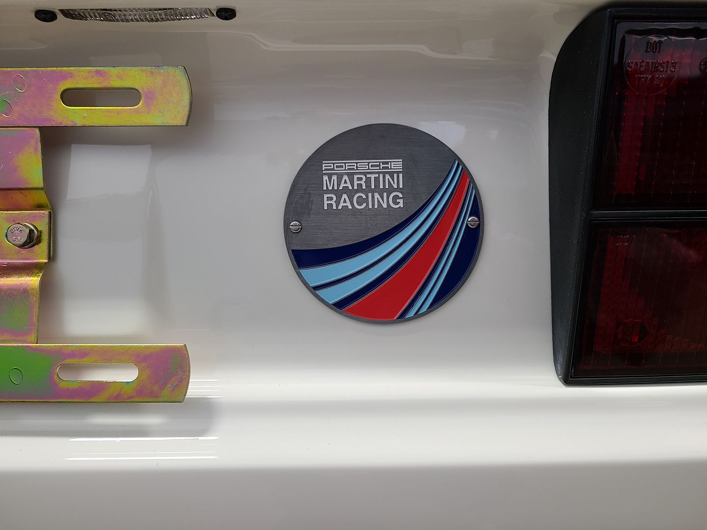

Again, it is all in details. Found this limited edition medallion from Porsche. It completes this restoration perfectly.

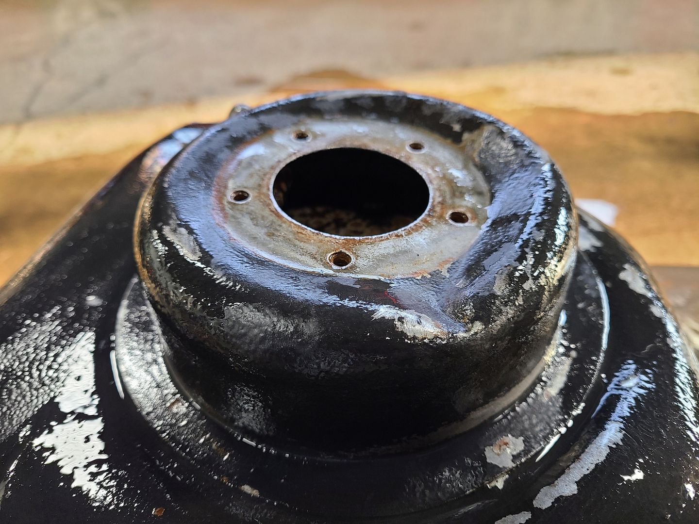

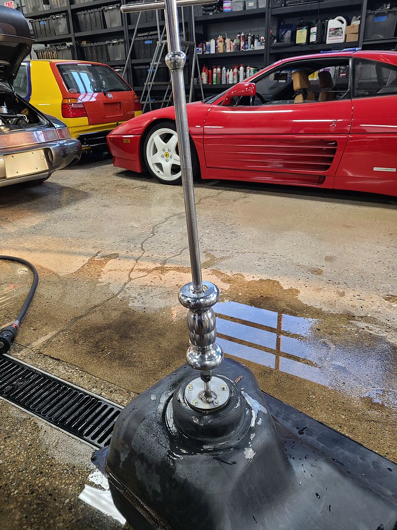

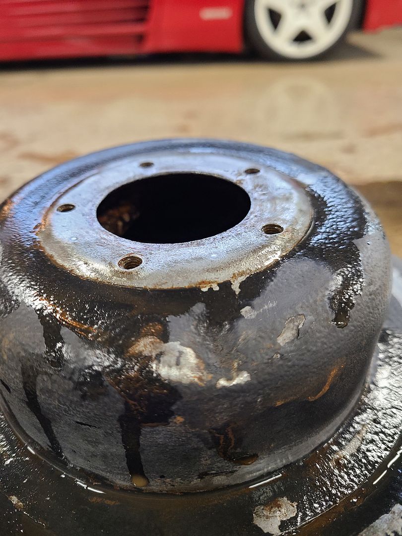

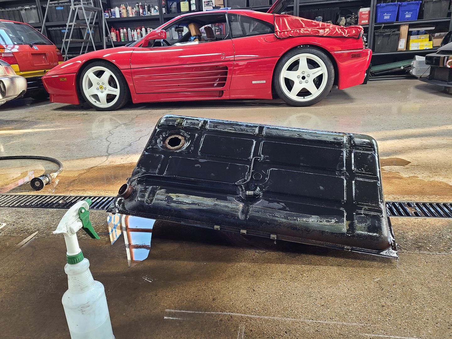

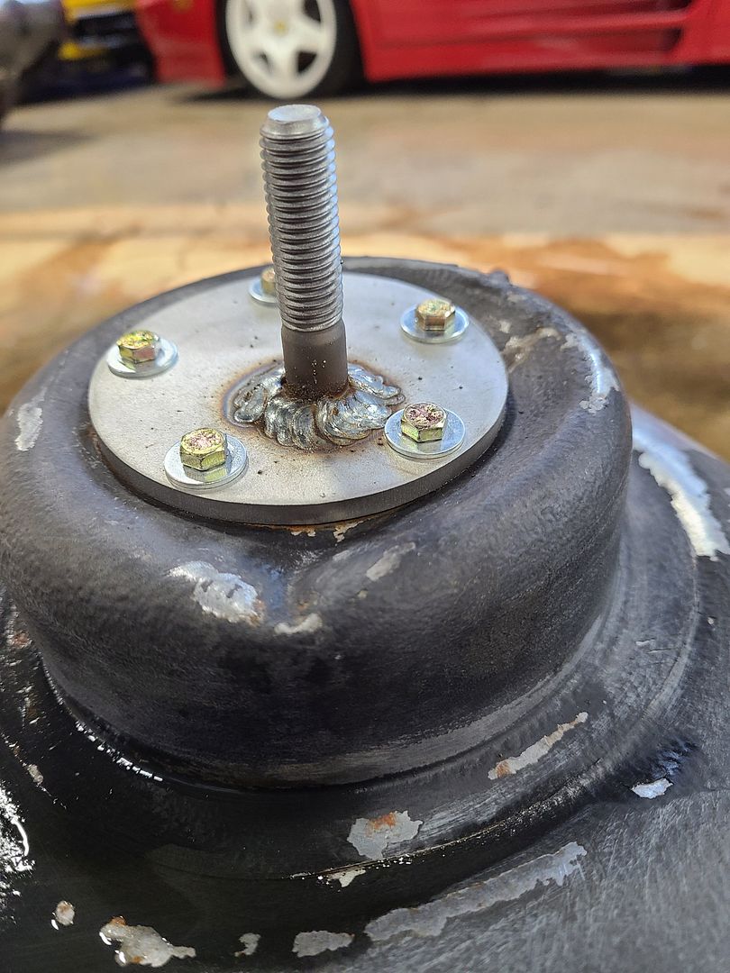

Time to work on fuel tank. Cleaning, fixing dents and full POR 15 liner for inside. Had to build a tool for slide hammer to pull the bottom that was damaged by jacking car up under the lowest part of the tank.

Much better !

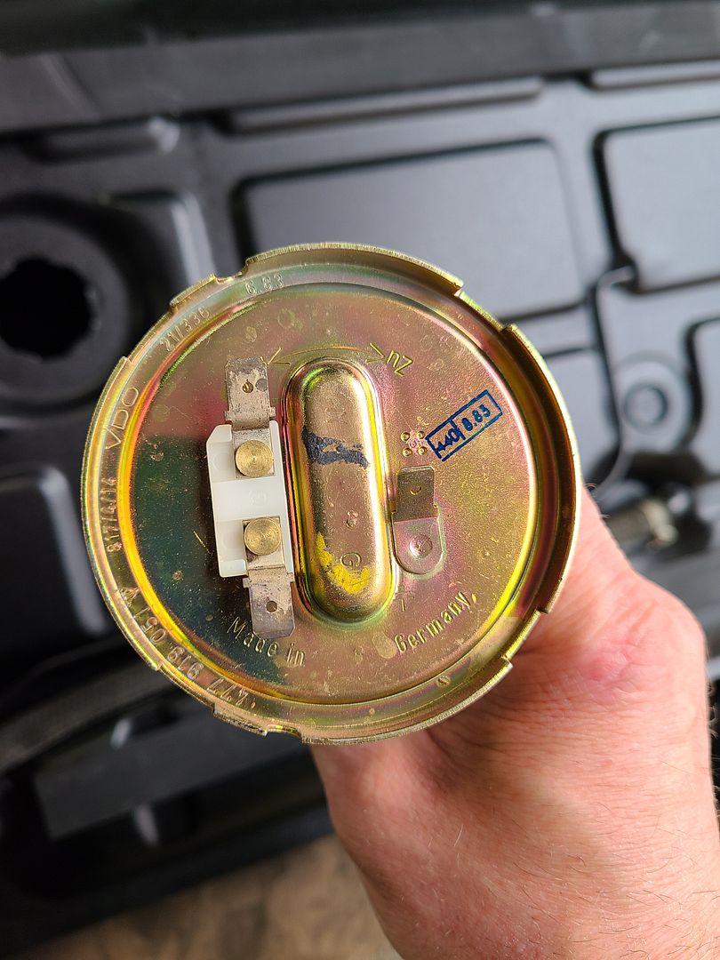

Another early model, unobtanium part. NOS fuel sending unit.
