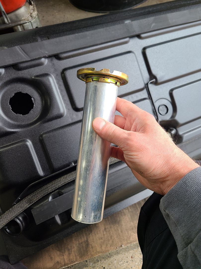

Fuel tank is cleaned and sealed with POR 15 kit. What a time consuming process! I also repainted it with truck bed liner. Tough coating and nice finish.
