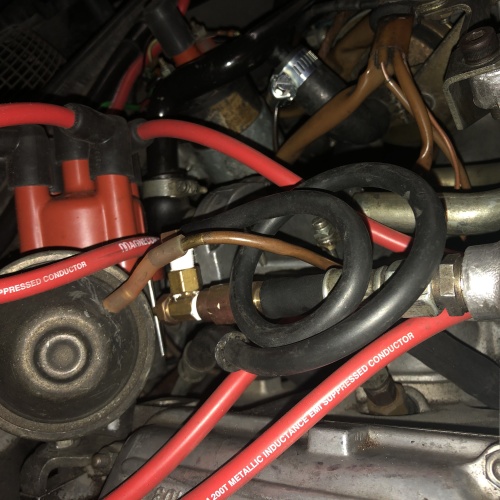

PostPosted: Tue Jun 16, 2020 3:47 am    Post subject: Reply with quote
chuck21401 wrote:
This is my temporary set up and recognize that it isn't ideal.
It does take some fiddling to get the boost level right. I found that even a 1/4 turn can make a huge difference.
I've found that the boost level is mostly consistent...but after a long run the boost level creeps up. I'm wondering if it has to do with heat....and if that is the case...would need to find a cooler spot under hood.
I installed a turbonetics MBC over the weekend similarly to what you show in your picture but it doesn't seem to work. No matter the adjustment, 7 psi is the max boost I see on the in cabin gauge.
The strange thing is that previously it was set to 10 psi with a small spring loaded valve that worked fine. Since I couldn't get the turbonetics MBC to work, I reinstalled the previous setup, but now adjustments don't work on that one neither.
Any thoughts?
1980 - 931
chuck21401
Joined: 20 Feb 2005
Posts: 320
Location: Annapolis, MD
PostPosted: Tue Jun 16, 2020 4:17 am    Post subject: Reply with quote
Any thoughts?
If the WG is opening at 7psi that tells me that the line is not being restricted and that you don't have leaks in the control line...enough air is pushing the spring up to open the WG.
When I first connected the turbonetics MBC it didn't seem to work. I cranked it all the way UP (+) according to the +/- on the dial....and still had stock boost. It took me a while to figure out that turning the knob down actually increases the boost...turning it down restricts the flow. I turned the knob all the way down (-) and the boost went to the moon...I let off the gas as I saw the boost gauge heading to 12psi in a hurry. From there I was able to adjust it to 9/10psi. As I mentioned above...a 1/4 turn makes a big difference....so it might take several runs to dial it in.
Can you remove the MBC and test it to make sure that air is being restricted? If you turn it all the way down...no air should pass through it. Of course make sure the air is flowing the right direction. If you connect it backwards it might not work correctly.
That doesn't make sense. Not sure what is going on there.
