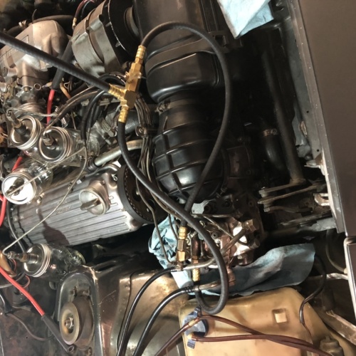

CIS pressure test results:
Ambient temp | 25C | 78F
System Pressure | 5.8 bar
Cold Pressure | 5.0 bar
Warm Pressure | 5.3 bar
Leak Test @ 10 min. | 2.0 bar
Leak Test @ 20 min. | 1.9 bar
So my cold and warm numbers are very high. Why is that?
My setup...

Could be the WUR or a flow restriction somewhere between the FD, WUR, and WUR return line..
You ever run Techron FI cleaner in the tank for a while?
Those high control pressure #s would make you lean, so don't go boosting hard on it like that..

Here are my results after adding the Techron. I also drained the gas tank and cleaned the screen on the in-tank pump. Verified the injectors where shooting a good spray pattern with similar volumes between the 4.
CIS pressure test results (Round 2):
Ambient temp | 20°C | 69°F
System Pressure | 6.0 bar
Cold Pressure | 5.7 bar
Warm Pressure | 5.8 bar
Leak Test @ 10 min. | 2.1 bar
Leak Test @ 20 min. | 2.0 bar
So, it would appear to have not really helped. One additional thing of note is that I was measuring 9.4 v at both pumps while they're running. Is that correct?

Well, if you are sure you have you valve on your tester wide open for the control pressure test, it would seem that then next thing to do would be to remove the WUR and either replace it, or try taking it apart for a good cleaning the best you can and see if you can fix it that way..
Seems the electronic portion of your WUR is working but the valve and/or screen in it are likely plugged up with gunk or rusted or something..
They can be sent our for 'rebuilding" but who knows right now...
I'd try cleaning it myself if I was you, and if that doesn't work, I'll sell you my old WUR for less than a rebuild costs, if you want..
They are a little bit of a pain to remove but not too bad if you are good at doing things by feel..
