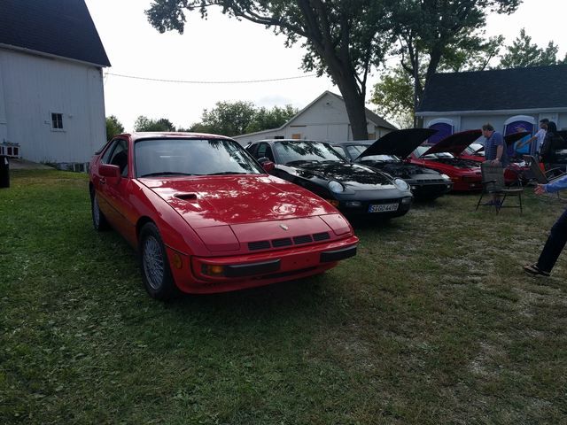

The Car and the Problem
Car: 1981 924 Turbo S2, US spec. Car's been in the family since sometime in '82 as my parents bought it instead of waiting for an NA 944 (good choice in my opinion) and spent what they had saved for their honeymoon on the car. Since then it's been in the Porsche Parade, auto-crossed in Old County Stadium's parking lot, and my dad spun out in the turn 5 sand trap at Road America. To say there's some nostalgia with this car is an understatement; heck I got taken to kindergarten in the back seat! Fast forward a few years (decades) and as the car was for some reason promised to my elder sister conditional upon her graduation from college, she chose instead to have my parents sell it to use the funds for her wedding. Yeah I wasn't going to have any of that. If anyone was going to buy the car it was going to be me, so I promptly did.
My parents rarely if ever drove it in the rain, it was always kept covered in their garage when not in use, waxed yearly and all around kept in good shape.

All in all the project took 18 months from start to finish and finish I just barely did. My goal was to have it done in time for the 92fourty party and it honestly took until the night before to get it running. She's now in storage for the miserable Wisconsin winter but I was able to get almost 1000 miles on the OD before the snow started to fall. How do the upgrades feel? Holy schmolly batman! It's like a whole new car. She goes like the dickens, easily feels like 200bhp and I'm only running 10psi at the moment!
Future plans include going EFI to get rid of the stock CIS system and non engine related I'm planning on doing a 951 brake system swap so I can run brembos. I'm hoping to get some dyno time this spring but that will most likely be after the EFI goes on so I won't have any really good before and after runs to compare.
All in all I'm extremely happy with how the car came out and in large part I have all of you on the board to thank for the posts and insights already on this forum and hope that this post adds to it.

Tyler is being somewhat modest in describing the heroic efforts that went into that last week before 92Forty.
I was there for the first fire on Wed 22 Sep 2017. We had it going by 9 PM that evening, but then hit a near-showstopper during the warmup. Tyler and his crew thrashed all day on Thursday, and we finally got word late on Thursday evening that he'd be making the maiden voyage to 924Forty the next morning. I know his parents were thrilled to be the "just in case" chase car for the 90 minute drive down from Milwaukee, to not only see the car arrive in style, but to be one of the first arrivals!
I still haven't gotten my first drive in it, but one of these Fourth Fridays soon, we're hoping for some comparo runs...
Great writeup, Tyler!!!

I could write another post this long just describing the week leading up to 92forty hahaha
I don't see any reason why she wont be at the April 4th Friday.
