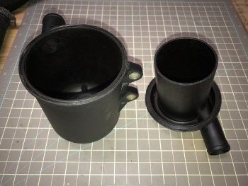

My car has been running great, but it drips oil after driving. While trying to find the source of the oil leak(s) on my S1-931, I found this in my air box...
I took apart the Air/Oill separator, but the inside was actually not that bad. Just a lot of carbon buildup that easily cleaned up with a little scraping.

I would agree that removing the breather while the engine is in, without destroying it, would be damn near impossible. Iíve yet to see what the inside of a clean one looks like. Mine doesnít appear to be clogged in my opinion, but I donít know how clean it should be? I can stick my pinky into the tube and feel that there is a gap between the outer housing and inner ďbaffleĒ? Any ideas?
And for anyone interested in what the inside of the air/oil separator looks like, hereís mine with the cap off. The inside walls were covered in carbon buildup that came off easily with a little scraping. I plan on adding some steel wool and sealing it back up with silicone, so that I can reopen it easily if necessary. I read somewhere in an older thread that the wool acts like a baffle to help mitigate some of the oil in the air box. I suppose I should also make sure that the return line to the sump is clear as well.

I personally wouldn't put steel wool anywhere near the internals of my engine. Steel wool tends to shed small bits of metal over time and it would work its way into your oil. If you really want to put something in there, I would lean towards one of those stainless steel pot scrubbers. They have much larger fibers and don't fall apart like steel wool will. I'd imagine you would have to put a lot of baffling material in there to make a difference. It looks like you would have to fill the cavity to the top.

Donít put anything steel in the Purolator. Obvious reasons
Donít restrict the crank case breather hose either on a turbo. You will cause other issues in the system. Intake system under vacuum pulls positive sump pressure out for a reason. If you donít want oil vapour going into the intake system, then use a vent to atmosphere oil catch can instead of the purolator. Recommended for higher boost engines. Not needed on stock boost. But you will end up with oil vapour build up in the engine bay which will need cleaning periodically.
