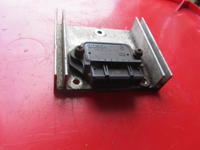

I had previously removed the electronic component. . .to clean off corrosion.
What did you find in there? Is this good maintenance? Are there alternative plug and play solutions for this part?

That ignition amplification module is a standard BOSCH part.
The one original with the engine in my red car died 9 years ago so I replaced it with one from a VW Passat.
I seem to recall some corrosion (was at least at the beginning of this year, if not earlier).
No, apparently this was not good maintenance! Maybe if I'd used some proper conductive paste (like from Radio Shack or other electronics supply place).
I'm tempted to re-paste it and reinstall, see if the problem returns. Glad to hear that it's a common part...
According to the photo of the one I took off, I see part # 211 905 351, mfgr is Fairchild, and it's clearly marked VW/Audi.
Edit: exactly this part:
http://www.ebay.com/itm/like/151747513189?lpid=82&chn=ps&ul_noapp=true
$30 on eBay, apparently there are new ones too. Hell, that one above is around the corner from me! LOL
Yeah, Walmart sells a new one!
https://www.walmart.com/ip/NEW-IGNITION-CONTROL-MODULE-FITS-EUROPEAN-MODEL-1979-1989-VOLKSWAGEN-211-905-351A-B-D-0-227-100-116-0-227-100-118-0-227-100-137/113340650?wmlspartner=wlpa&selectedSellerId=1134&adid=22222222227050039562&wmlspartner=wmtlabs&wl0=&wl1=g&wl2=c&wl3=145320267749&wl4=pla-261006180645&wl5=9016902&wl6=&wl7=&wl8=&wl9=pla&wl10=112343853&wl11=online&wl12=113340650&wl13=&veh=sem
One more, original part # (per the PET parts catalog) is 191 905 351 A... Google search shows it turning up as a VW Golf Mk1/Mk2 ignition control module...
PS - thanks to John Brown for providing the part!

Wait, that little black bugger is inside the silver box on my driver's side fender?
Wow, Autohausaz has it for $35, with a list north of $300. If they're subject to common failure, seems like a decent maintenance item.
Jup, i got problems with it to when I first got my engine running, occasional hard starting and missfires, sometimes it ran really well. An s2 engine though, got mine from a Volvo 740 for free

They are different between the NA the S1 turbo and the S2 turbo...each of them uses a different ignition amp module.
The NA and S1 turbo are silver encapsulated boxes(different part numbers but same shit inside) while the S2 turbo and all the GTs have a black more modern part thats cheaper and found on all 90s VWs.
A key fact. It appears the S1 units are. . .um. . .pricey.

So, is there supposed to be thermal paste on the back of these?
I can't say that I'd ever noticed that before... kinda makes me wonder if I should address that on mine, too.

It would make sense that there should be. But mine may have just been going, for longer than I even realized...

No paste under mine either but then again I do get some misfires/detonation at high RPMS under heavy load so the ignition system may be under higher load as well...so i'm going to add some thermal paste under it...cant hurt.

Figured everyone on this thread might find this interesting...
I just ordered one of these cheap, $30 replacement modules from Amazon (the same 3rd party seller as the Walmart link, above).
Much to my surprise, when I opened the box, it actually included a small packet of thermal paste and an instruction sheet suggesting its application.
Validation!
