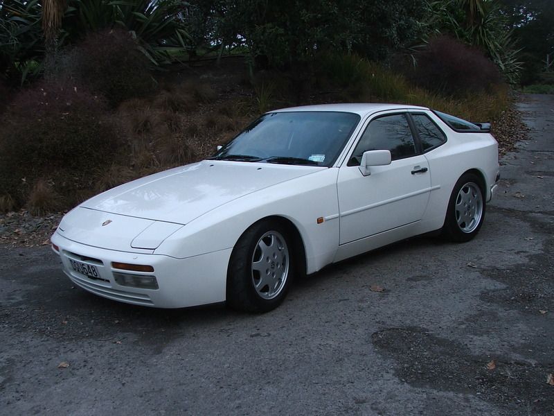

... and just for interest, and way of introduction, this is my current project
