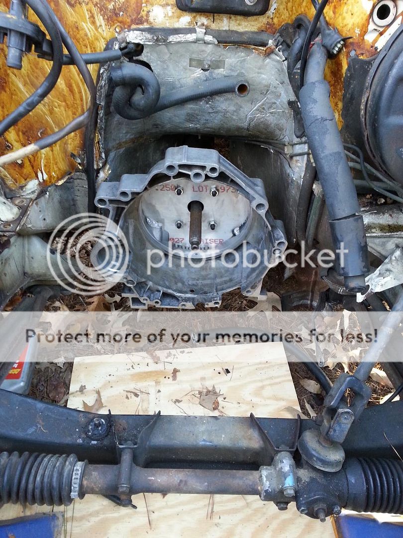

Well it's bolted to the torque tube. About to make some mount pedestal templates.

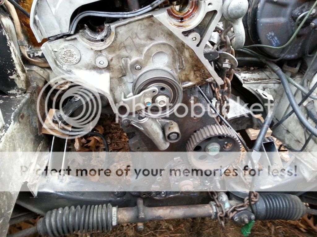

It sits on it's mounts.

That looks pretty good but I would reinforce the mounts somehow as there is a big mass sitting on them dynamically. So for example the crossmember is stressed torsionally because it has a long lever you just welded on.
I would at least lengthen the support downwards until the end of the crossmember...if not continue the supports on the front side.
The 40-50mm of weld you did might not hold that long.
PostPosted: Wed Feb 04, 2015 7:36 pm    Post subject: Reply with quote
You can't see it in the picture but they will be supported from the back side by a threaded rod attracted to the original mount point.
PostPosted: Wed Feb 04, 2015 8:06 pm    Post subject: Reply with quote
hmmm, personally I would have made new mounts off the chassis rails... your location is quite far back to warrant this as opposed to bringing them forward to the crossmember, similar to what macbdog did with his chev conversion...

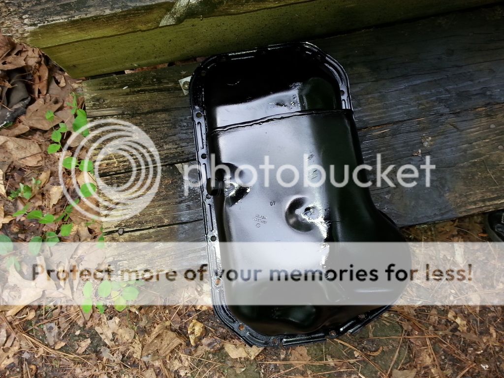

I made an oil pan. Please excuse my poor welding. I know it has a hole in it. I bought a cheap used one incase I screwed this one up I wouldn't lose money on it. The hole had a rubber plug in it, I plan on welding closed then I'm going to pressure test it and paint it if it passes.

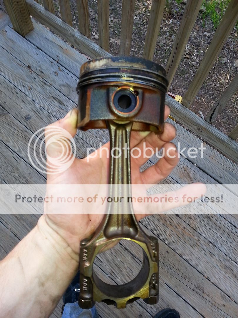

1.8 pistons are light and small.

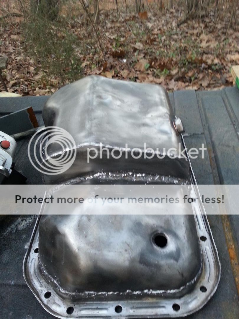

I finished my oil pan and crossmember then painted them. I finished the downpipe. Also received almost all the parts I require for the bottom end build.
