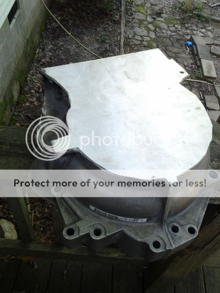

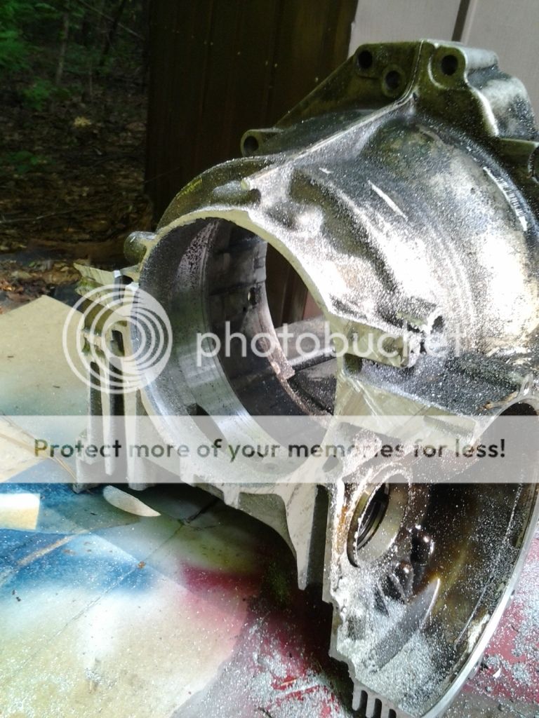

I sawed the Passat transaxle in half. It will require some more cutting and a little grinding to make a good bellhousing.

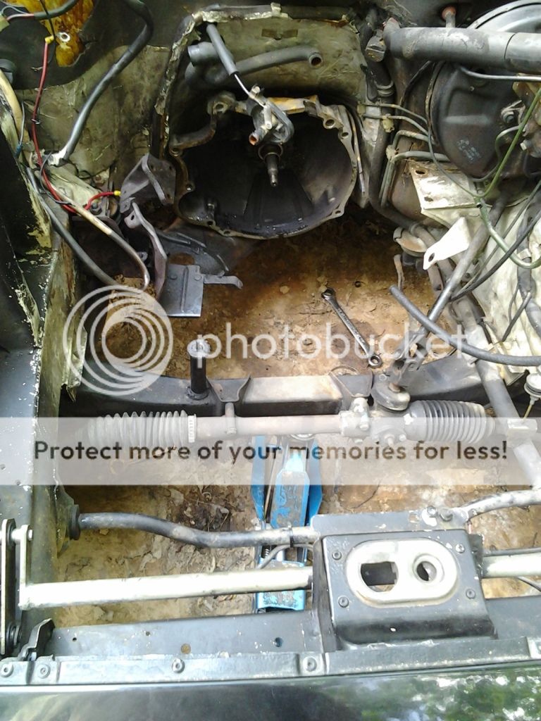

I haven't made much progress lately. I got the engine and transaxle out but the torque tube Iis still in there for now. The car looks like a 4x4 with no drivetrain.
PostPosted: Mon Sep 08, 2014 11:07 am    Post subject: Reply with quote
I made the final cut on the bellhousing before it is sent to the machine shop.

Sent what was left of my Passat transaxle off to the machine shop on Thursday. I should have it back next week. I'll take it to my cousin to weld the back plate on after I get it back. Then I'll mock it up for my torque tube holes. Then test fit/motor moumt design.

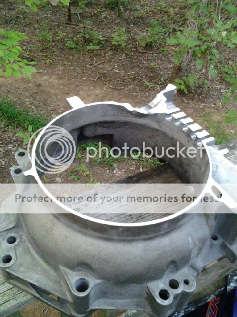

PostPosted: Fri Sep 19, 2014 5:52 pm    Post subject: Reply with quote
Got this back from the machine shop. Things will start happening soon.

PostPosted: Mon Oct 06, 2014 12:17 am    Post subject: Reply with quote
I got this welded on yesterday. It will soon be time to drill holes, then comes transaxle install and motor mount fab.
