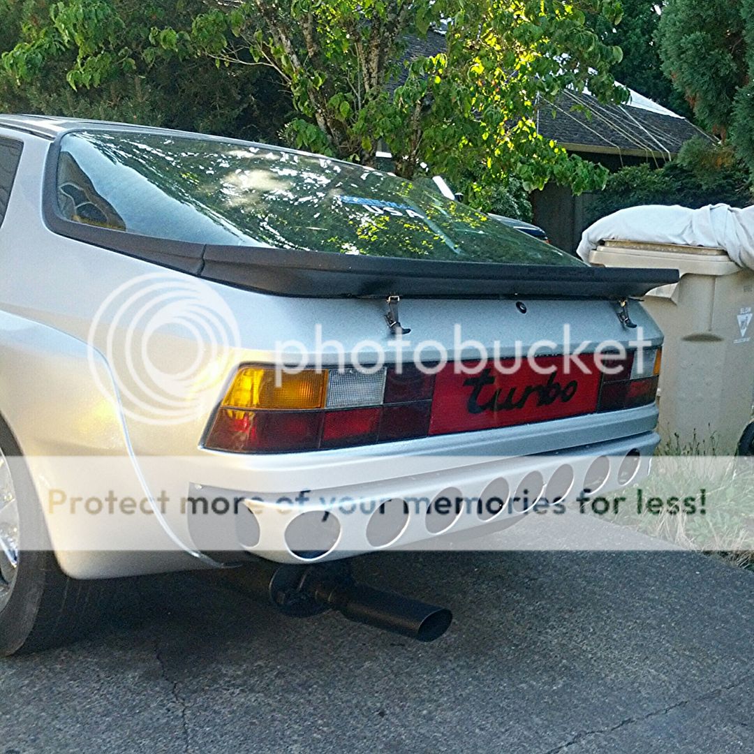

The brackets: Flat base attaches to factory latch pin mounts, bent piece hugs curves of the hatch. Does not touch body!
Pegasus Racing generic t handles.
T handles slip over the hooks, and don't need to be attached, making them easily replaced.
Factory mounting points (M6).
Installed.
Receiver riveted to body.
Done! No hatch. . ."incidents" on track.

PostPosted: Fri May 03, 2013 4:36 am    Post subject: Reply with quote
very cool. rattles?
any way of getting dimensions on the brackets? or buying a pair?

PostPosted: Fri May 03, 2013 9:37 am    Post subject: Reply with quote
Did you fab the brackets in the first picture?

Posts: 11413
PostPosted: Fri May 03, 2013 11:01 am    Post subject: Reply with quote
I did fabricate the brackets. Considering a small run. . .stand by whilst I figger.

PostPosted: Sun Aug 03, 2014 6:05 pm    Post subject: Reply with quote
I followed suite and made a pair. I had predrilled holes I didnt
fill when I painted so I went rogue.
Great idea dude.
