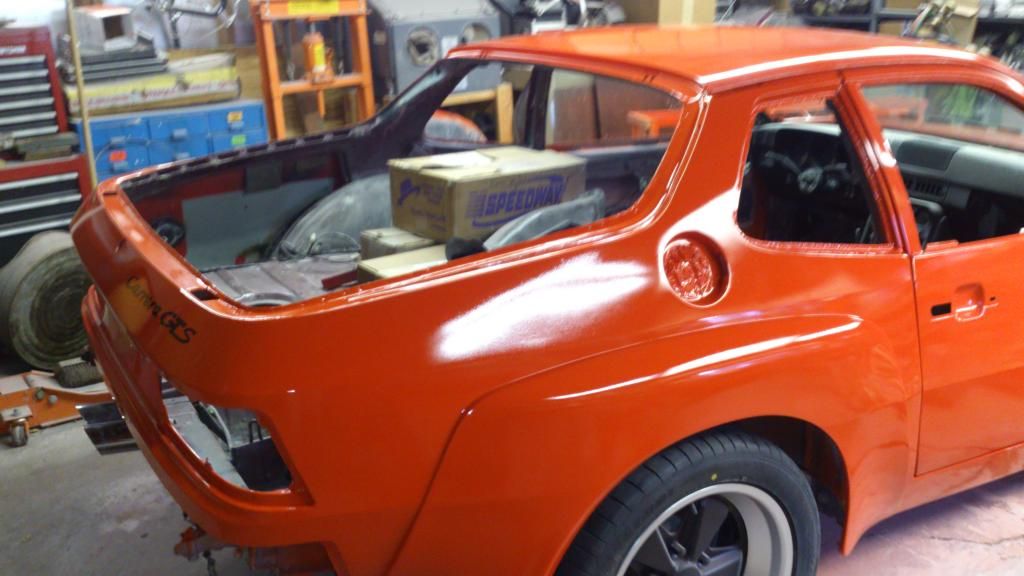

PostPosted: Mon Nov 03, 2014 10:55 pm    Post subject: Reply with quote
Rattle cans? No.
Two stage lacquer.

PostPosted: Mon Nov 10, 2014 3:37 am    Post subject: Reply with quote
Clearcoated. I just need to buff and polish it now.

PostPosted: Fri Jan 09, 2015 4:40 am    Post subject: Reply with quote
It's coming along! Mostly what is remaining to do is the interior and a few minor mechanical things.

PostPosted: Sat Jan 10, 2015 2:43 am    Post subject: Reply with quote
GeorgeV wrote:
Rasta, you're still a ST!
The car does look great, but I was having a hard time imagining using a pro-style paint gun without a paint booth.

PostPosted: Sun Jan 11, 2015 9:15 am    Post subject: Reply with quote
It isn't a problem because I used Lacquer. If I used If I used urethane or canalized enamel I would have needed to make a kind of booth with plastic sheet.
I'm almost ready to put the interior in now.
