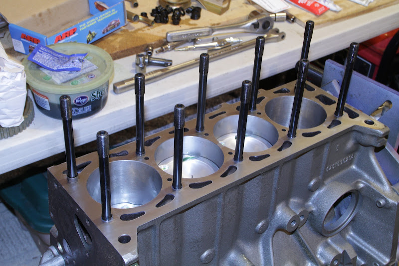

Head studs:
Head and water pump installed:

Head studs:
What torque specs are you using on those studs?
I'm using the instruction sheet that came in the package, which says to use the ARP assembly lube, and then torque to 90 ft lb in three successive stages, following the factory tightening sequence. I started at 45 ft lb, then did 70 the second time around, and finished up at 90.
