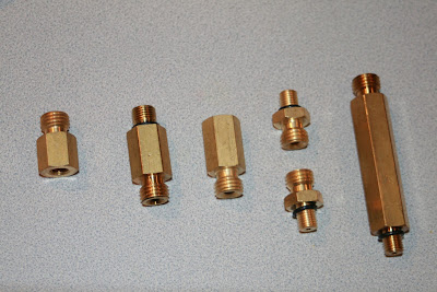

ADAPTERS for 1973-Current Porsche applications
(see diagram below)
Fuel Distributor: R14I40 + o-ring R14K
WUR Hose: R14I41 + bolt and copper crush washers from fuel distributor
And here is a photo of the Hoffman CIS Tester with the two referenced adapters, and my notations on the tester itself indicating which line should be attached where. The glare from the flash might make it a little hard to see, but if you look carefully, you can see that the line that comes out of the LEFT side of the gauge has no valve and is labeled FD. The line that comes out of the RIGHT side of the gauge has the valve and is labeled WUR. You can see the fittings for the appropriate connections laid out at the end of each hose, which correspond to the part numbers in the diagram above.

Hey are you able to upload pictures of teater plugged in the vehicle ready to be used as cannot figure out how it has to be connected, I have the official Porsche part VAG 1318 I have no idea where to hook it in to
Vass...
