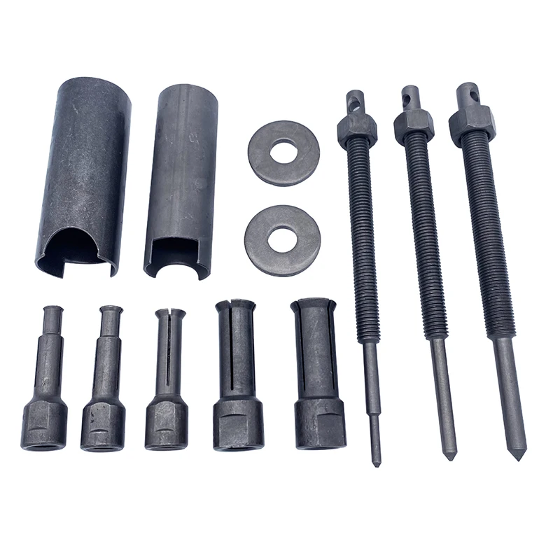

Just purchase something like this, took me about 5 minutes.
It also works great for replacing the SuperCharger bearings of an m45, but that's another story |

Even if I could just buy something like that, I don't think it would have worked in my situation. |

Yeh I find it hard to envision what you did exactly. Only thing I can tell is that I removed the bearing (not the sleeve, as I don't see the need to do that) from my '78 engine with ease. |
