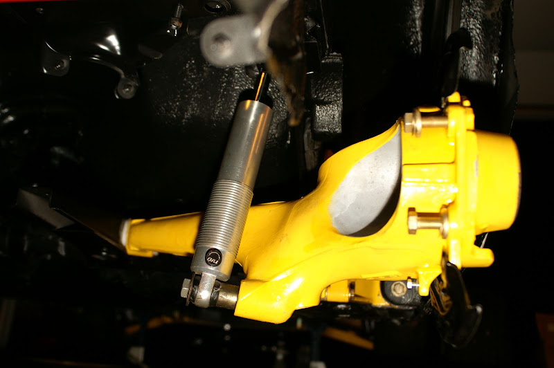

Here's a question...wondering if it would be in the "spirit" of a club sport to swap in rear alu trailing arms...would reduce weight and facilitate coil overs should the need or desire ever arise...

Would this also let you use later shocks? If so, I'd say sure. Also, it would seem to meet the criteria for the purpose of Club Sport if they are lighter.
Yep, here are late offset arms on the UWB. As you can see, the rear shocks are setup for coilovers, although at this point, I have chosen not to add them to the UWB. From my experience in bolting these up, it was a piece of cake...change the trailing arm, and no issues using the later shock stuff from 944/951. I presume that the 968 stuff is interchangeable as well, although I've not 100% verified it.

That looks great. Yes, my understanding is 968 is bolt up for 951.
