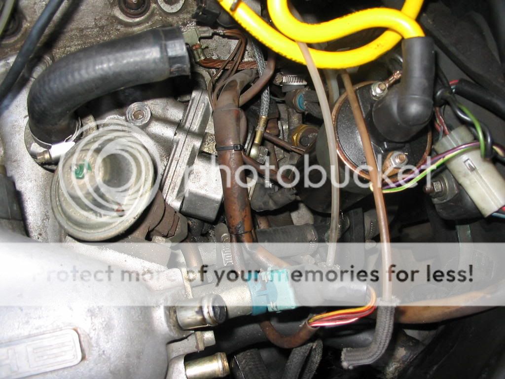

having problems with the puter only lets me send one pick at a time.this is where the lines to the inj. are removed,and the banjo bolts are replaced into the inj. to keep out any possible dirt and greebly things!! see all the cali.emmisions hoses an tubes an pieces that you just dont need.Note:look at my throtle shaft bushing a tad worn out wasnt even geting full pedal!!Doh!!anyway these are theparts i have for sale all is in good running shape.Note new fuel lines and all is Kalean!!

this here pic you can see alot of the vacuum hoses and cali.tubes and wotnot are removed.Note:down the side of the coil you can see 1 more new line hooked to the WUR attached to the intake manifold....Well theres 1 more fuel line under that one!!do yourself a fovor and remove the 2 coil nuts,( not the ones with the wires the 2 that hold the coil in place) and flop the coil onto the drip rail.dont ask easiier to get the banjo bolts!by the way if any one knows the proper names to these parts please chime in,and ill edit the names.also you can see the hot water valve that seize up all the time just in front of the coil.this ones seized.

a nouther pic with the hoses and stuff still there
