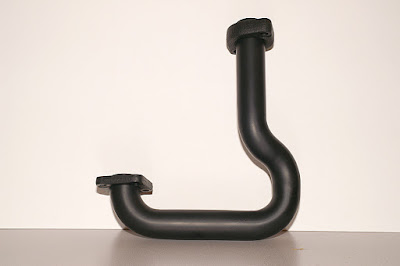

WATER COOLED HYBRID TURBO HAS ARRIVED!!!!!!!!!!!!! WoooooooooHooooooooooo!!!!
Here's the pix...I'll come back later and post the part numbers. (Click pix for larger images).
Ceramic-coated exhaust manifold (series II)
Ceramic-coated J-Pipe

PostPosted: Fri Jun 06, 2008 8:29 am    Post subject: Reply with quote
But of course you mean ceramic coated, not powder coated.
  • Weiße Scheiße (1987 924S) - In Progress
Posts: 15489
PostPosted: Fri Jun 06, 2008 8:37 am    Post subject: Reply with quote
Oops Yes, I meant ceramic, not powder.
