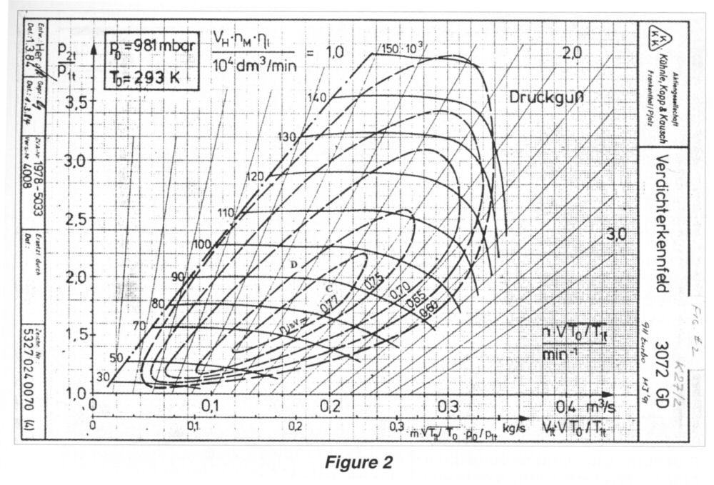

Incidentally, here is a compressor map for the K27 cold side. This should give you an idea of the power range / CFM I can produce while remaining within the peak efficiency of the K27 compressor.

The other big piece of news is that even though I sent a K27 unit, it turns out that the compressor wheel is NOT a K27 wheel, but a "3LDZ" wheel. John said that it either superceded the K27 wheel or the other way 'round, but he wasn't sure which. I'm in the process of hunting down a compressor map for the 3LDZ wheel, but no success yet. John is going to contact Borg Warner to see if they have one. Just to verify that the 3LDZ compressor map is close to the K27 posted above.
As for the hybrid results, John confirmed that the compressor map I posted and the HP / CFM targets I posted were definitely well thought out and aligned. So, at least theoretically, this approach should work for what I'm trying to accomplish. Always good to get that confirmation from an expert!!!

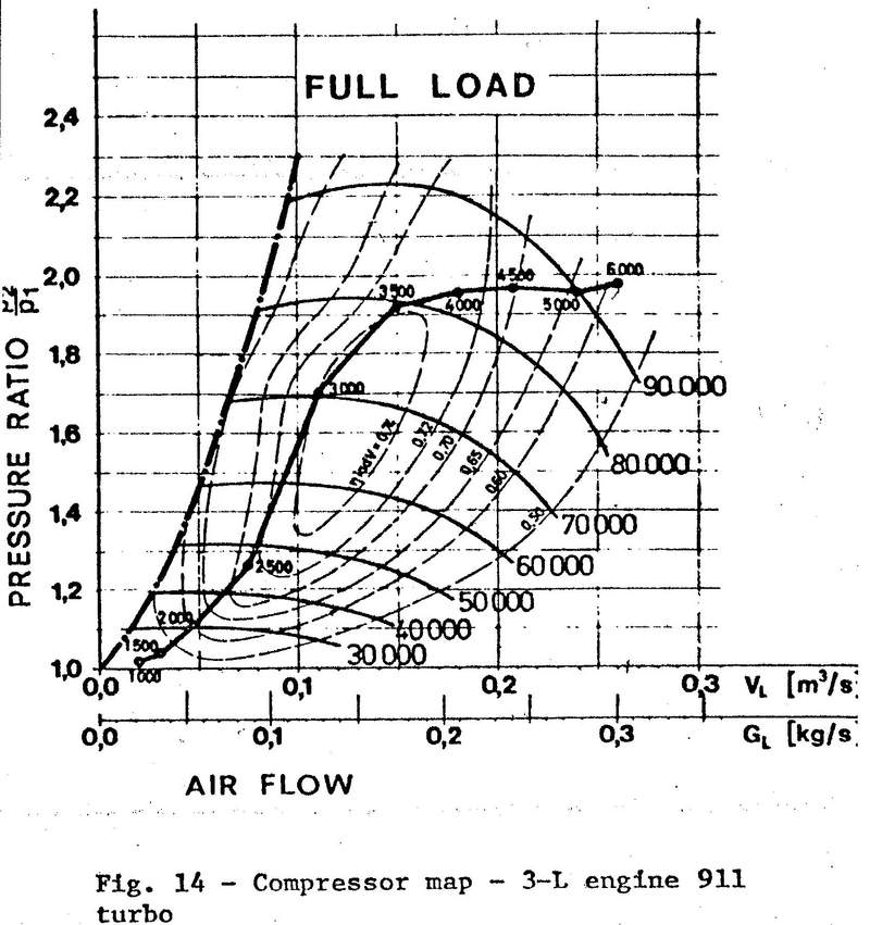

PostPosted: Sun Mar 09, 2008 6:24 pm    Post subject: Reply with quote
I have finally located a compressor map for the 3LDZ (!!!!) thanks to "copbait73" over on Pelican (here's the related thread over there...).
Here's the 3LDZ map:
