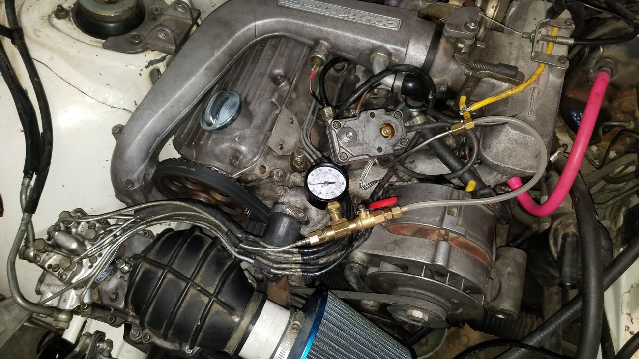

I was able to bend it by hand gently, mostly right at the CIS meter as it was one of the injector lines that was straight.
heres a pic of how I installed the gauge permanently.
It was either this or a giant box of legos

It’s likely you will get a very weird warmup when your WUR is not bolted to the intake to keep it “warm”..
Might start rich, lean out, then drift back rich..
